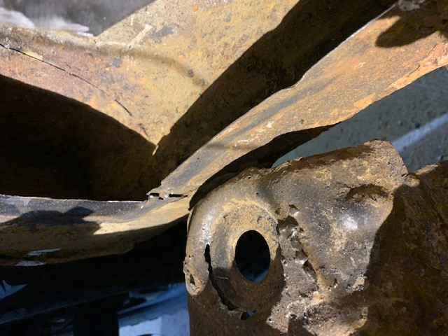

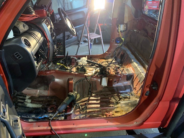

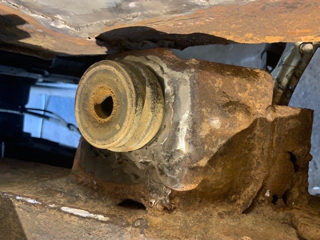

Made a start on the rear passenger mount today as it was easiest to get at after stripping out all the interior & carpet. I put a scissor jack and bit of wood under the body from the back onto the chassis rail and removed all the body mount bolts. It jacked back up pretty easily and at least isnt now sitting on the cage and is supported for working on it.
I can already see the floor is bulged up a bit where the mount is pushing on it from below

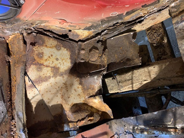

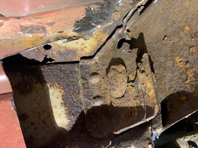

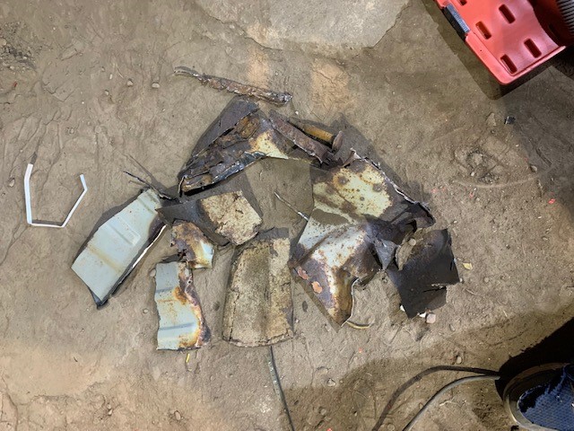

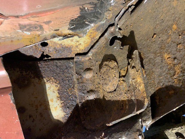

After some cutting with mr angry and some attacking with a hammer and chisel this was the first layer of nastiness exposed:

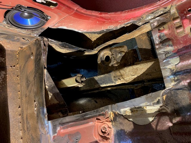

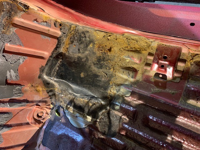

Attacked it with everything going (grinder, flap wheel, needle gun, pokey sander thing, etc) to get it cleaned back to half solid metal. Quite a bit more of the side panel cut out below the seatbelt too.
Keith you are right about the body mount being done in too. Overall the chassis isnt great, but will last a bit longer yet. The mount needs replaced though, so I will replace them all and make my own version instead of patching them again.

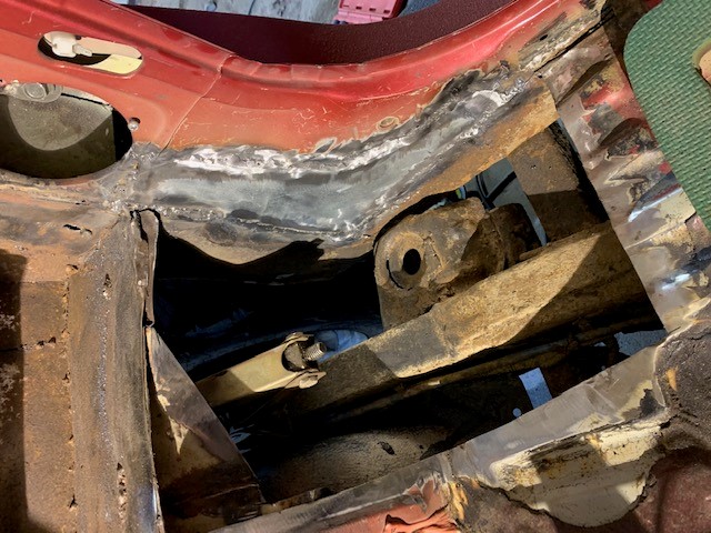

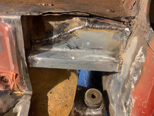

Used a bit of Dave's CAD to make a template for the patch piece below the seatbelt. Plate cut from some left over 2mm galv sheet and welded in (galv ground off on welding areas as it gives off chlorine gas when welded apparently ). That bits not going to rust away any time soon at least

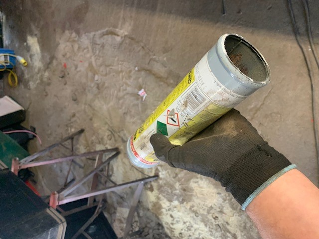

Oh, and I had cause to use the fire extinguisher on the car today. I thought i was being clever by spraying some of the buzzweld cavity wax in to the sills while it was open and easy to get at. Totally forgot how flammable the vapors from it are and started tack welding the plate in. Sudden womph noise and lots of flames Cue fire extinguisher that luckily I had remembered to keep handy. Quickly sorted it out and no damage apart from a singed hair smell from my eyebrows

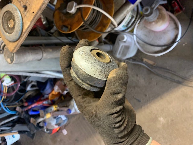

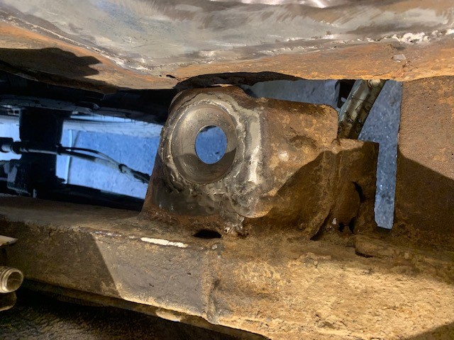

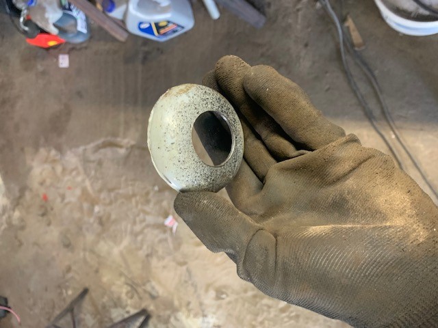

Started with the rotten chassis mount. Finally found a use for the empty gas cylinders too . Turns out the domed end of the cylinder is exactly the right shape for the body mount rubber to sit in and bolt through. Chopped it off and drilled a hole in it:
Drilled out the rot on the chassis mount with a suitable holesaw and welded in the new cup. Not as hard or bad as expected. Most of the mount is solid so I decided against totally replacing it for now.
Then onto folding a new bit of sheet to make the outer skin of the rear support. Took a bit of fiddling to get the right shape and weld in but its nice and strong there now, even if the welds look horrible .
Made a start on the inner skin plate and forgot to take a pic of it. Needs more fettling to get it right yet though. Thats tomorrow's job...
