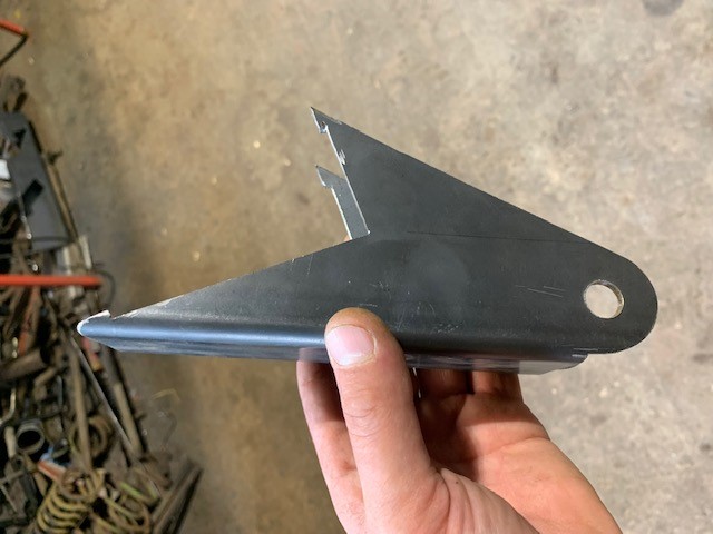

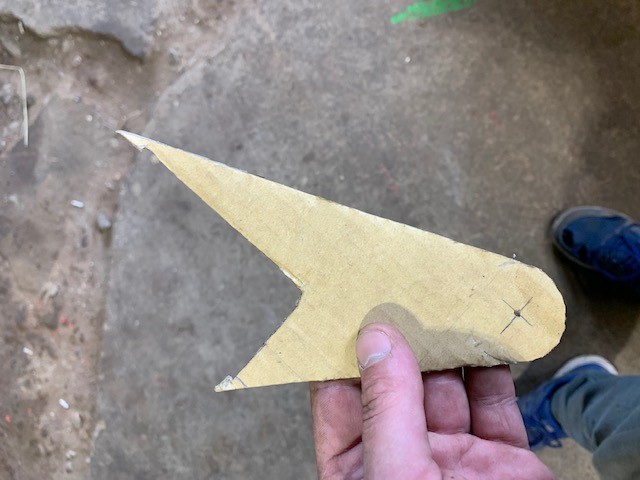

Finished off the panhard repair today. Used some of Dave's patent CAD to make a template for the drop to the bar and cut it out in the remainder of the steel box section Dave gave me (yes he even gave me the metal to fix it!)

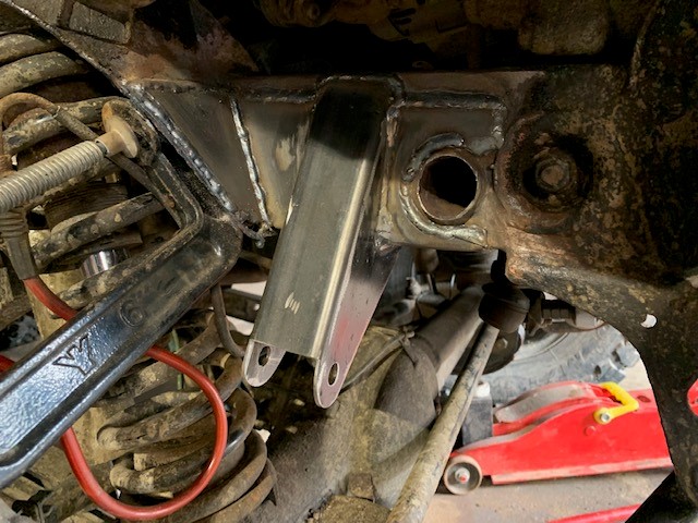

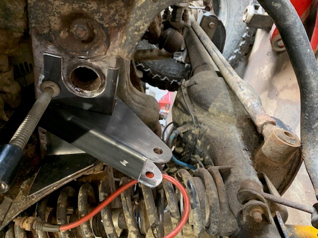

Quick test fit and measure to check its in the right place and has the correct angle of dangle
Then out with the welder to burn through some mig wire stitching the two bits together and onto the chassis. Ive welded up inside it as well as outside then all round the plate onto the chassis and spring mount. Nice and strong now.

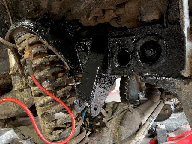

Then gunk it all up with Buzzweld CIO black
That paint dries really quickly so within an hour it was dry enough to put back on and go for a test drive. Steering wheel isnt centred so that means I need to adjust the bar a little, but what a difference. It must have slowly being going wrong for a while, now the steering is pin sharp
