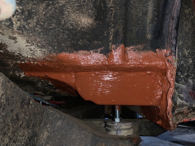

Looking good. By the way, when spraying cavity wax I find it helps to thin it with 10-20% white spirit. This helps it soak into thin gaps.

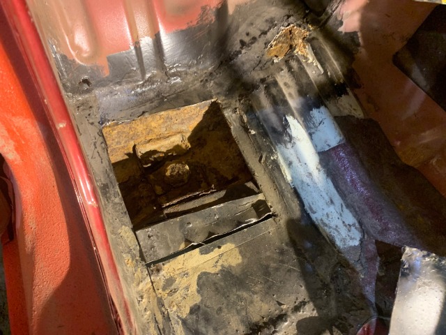

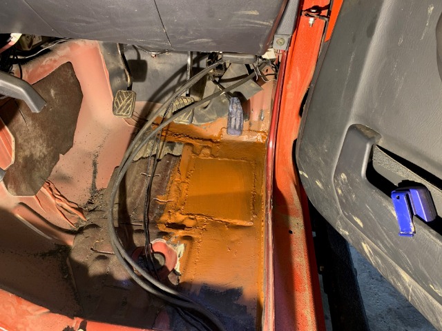

Finished off the driver side this afternoon. Welded in some more galv 2mm plate to fix the floor, doused everything in rust convertor then seam sealer and RCP paint. Ive bolted it down and all seems well. Just the passenger footwell to do tomorrow. saving the easiest til last

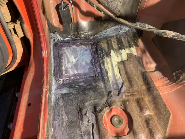

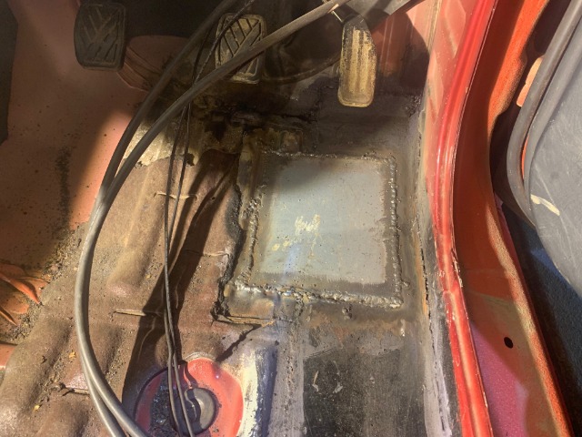

03 Oct 2021 15:47 #239108
Plenty of time
front passenger sorted out today. A mirror of job done on the driver side one. all liberally gunged up with seam sealer and RCP primer. I just need to stick it back together and refit some interior on friday/saturday and im good for 'laning on the 10th
