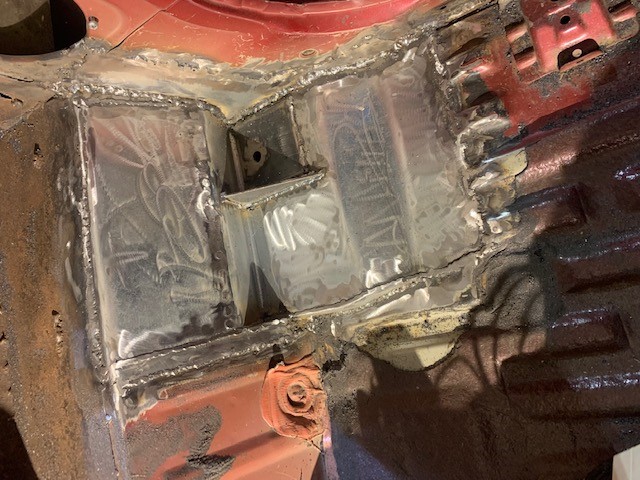

by LesNewell
That bottle end looks like a perfect fit. Your welds may not be pretty but they do look like they have reasonable penetration, which is what counts. Try keeping the torch as close as possible to the work. You may find the arc is more stable when you do that.

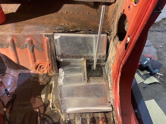

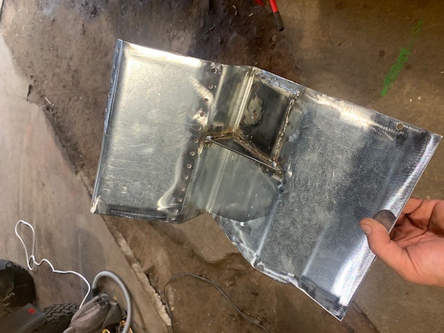

Finished off the second skin today. Put in an additional 3mm plate where the mount contacts and also a small diagonal brace beside it. Welded it all in and its awaiting seam sealer and paint now. Ive put a coat of the rust convertor stuff on everywhere that looks crusty and the new welds so it will be dry enough to seal/paint during the week.
Onto the other two next. They are at the front of the cab and all from underneath so itll be up on the ramps for that one.
