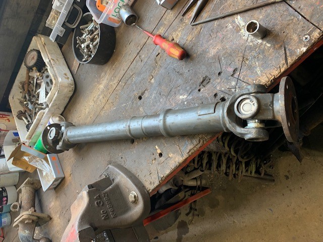

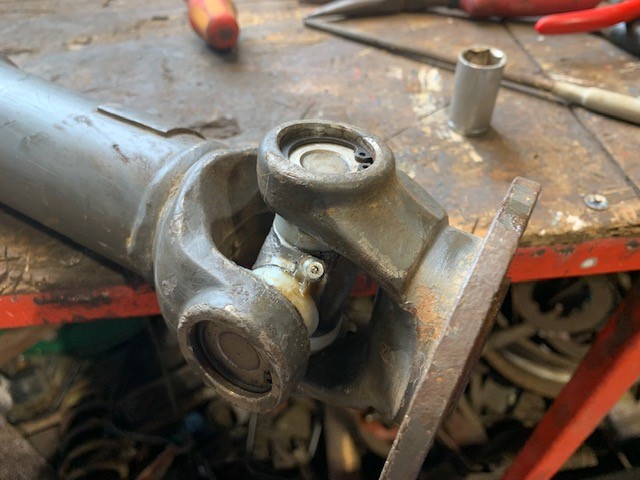

Bit of programmed maintenance today.
Up on the ramps and set the rocklobster transfer box off draining the oil and remove the rear prop while there.
When I did the new gearset in the rocklobster box I noticed the rear prop had play in the UJs. I stuffed it full of grease and ordered some new UJs for it from Firow (the people who make the HD jimnybits props). Next day 2 shiny new sets arrived.
Much fighting to get the old C clips off and then it was nice and easy to swap and grease up the new ones. Only a small thing, but it needed doing.
While I was under there I measured up the UJs for the SJ intermediate prop and they are 25x64 size. Trawl on the internet found some for less than £8 each (and greaseable ones too), so they are ordered for another day.

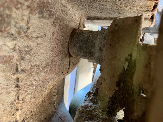

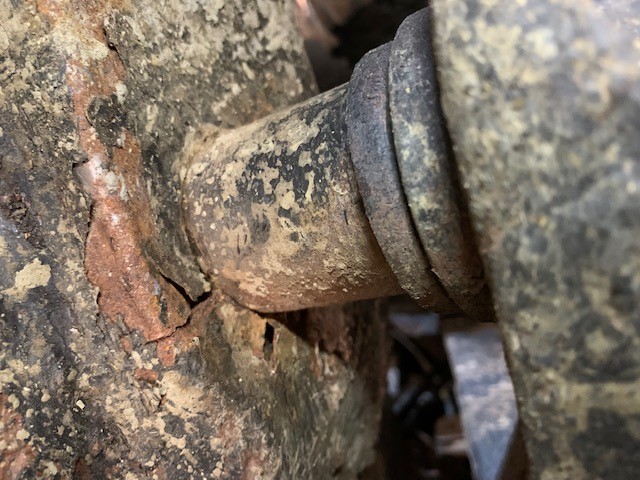

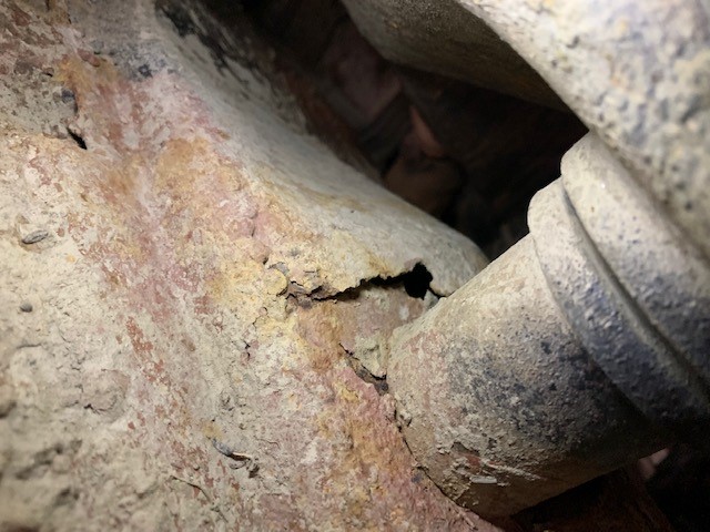

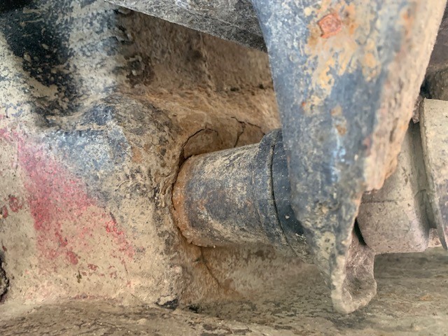

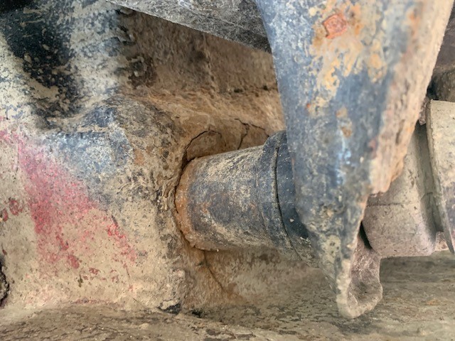

Pah! more problems. Today I was meant to be driving down to over night at Brett's house, before 'laning tomorrow. Set off and over a bump in the road. Lots of loud rattling & banging noises on any subsequent bumps. Pulled over and noticed the sills were sitting on the rockslider arms, look under and see that 3 of the 4 body mounts have pushed up into the body shell and are falling apart. Great
Nearside rear:
front nearside:
front offside:
So thats going to be loads of fun to sort out. Not even sure how to get at them. Might need to chop the mount off the chassis to get in there, or chop the floor out from above maybe?
Nearside rear:
front nearside:
front offside:
