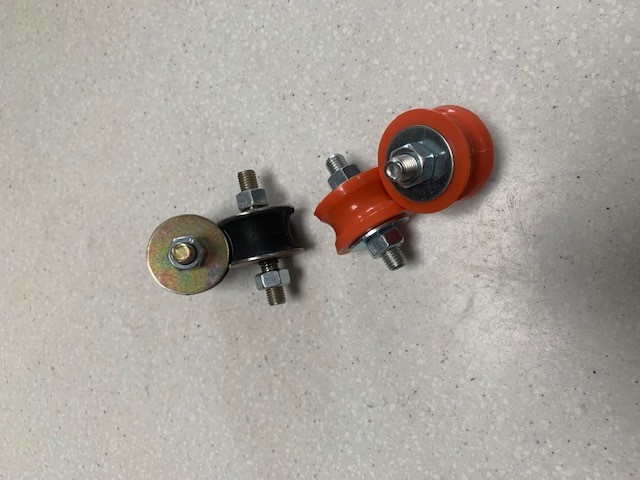

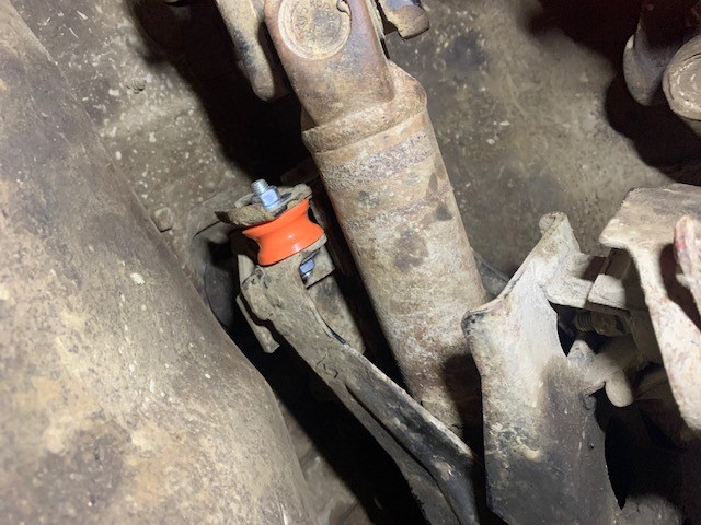

Replaced the gearstick bobbins with some poly versions as the rubber ones had split again. These seem more suited in terms of stiffness and work well for a cheap thing. They are classic mini exhaust hangars and about £4ea on ebay.

Riccy.
I am intrigued with your new bobbins. Are they two separate studs with welded on washers or a straight through section of all thread rod.
Cheers
Roger
Cheers
Roger
01 Aug 2021 19:03 #237236
Im not sure Roger. I used the orange poly ones and got the rubbers ones as spares.
The poly ones look like a thread all the way through, though without cutting them apart I cant be sure. The washers are loose on these ones.
The rubber are a thread welded to the washer and then rubber bonded between the two sides.
