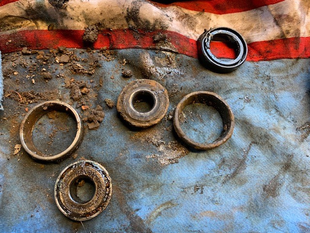

Finally think ive got the better of the wobbly steering. The steering bar was loose at the PS box end and tightening that helped, but it was ultimately the kingpin bearings, which I should have done when I was messing about with the wheel bearing, again on driver side. Passenger feels OK, so will do a test run tomorrow and see.

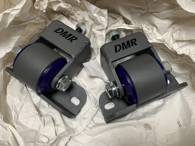

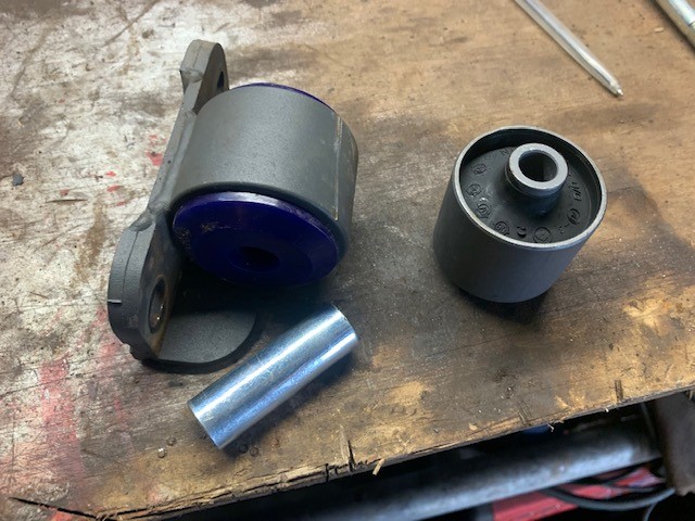

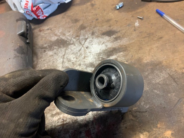

Then a bit of fiddling with a new design of engine mount, courtesy of Dave Marsh Racing. These replace the two original rubber mounts at the front to stiffen everything up.

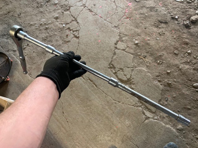

So out with 3 extension bars and managed to swap one side ok.
Fired up and its too stiff for my liking. The whole car vibrating like mad at idle speed, OK when driving though.
I had a suspicion it would be so had ordered some radius arm bushes from Martin earlier in the week. Back out and pressed in the rubber bushes instead. Now back in and is much improved. Still need to do the passenger side one, but that means taking off the exhaust manifold. Not got the time for that this weekend, but one seems to be enough to stop the wayward movement anyway.

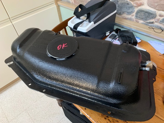

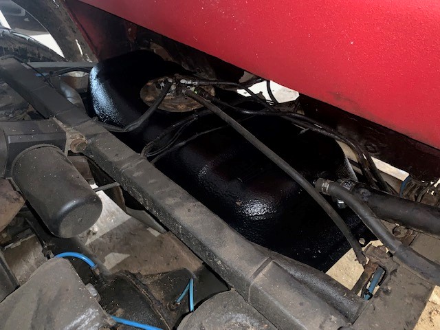

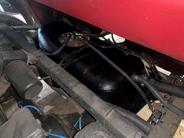

New fuel tank arrived from Martin yesterday
And what a fight to fit the thing. Luckily my back body tips, so I could get at the top of the tank. This allowed me to drain the fuel by removing the fuel pump assembly from above. I used a ball valve siphon hose which got 90% out into jerry cans safely. Handy gadget.
The filler and overspill hoses were easy to remove, but the tank was a real fight. The 4 bolts that hold on the guard all sheared off and one of the other two rounded instantly. The sixth gave no trouble oddly. It took about 3hrs to get it out and fix the snapped off bolts
Then to actually get it off I had to undo the rear prop from the diff end and tie out the way, then much wiggling to get it out and the new one back in. Refitted pump and pipework easily enough and I even remembered to transfer the little anti-siphon thing on the filler pipe. I would imagine its a right nightmare job if you dont have access from above!
