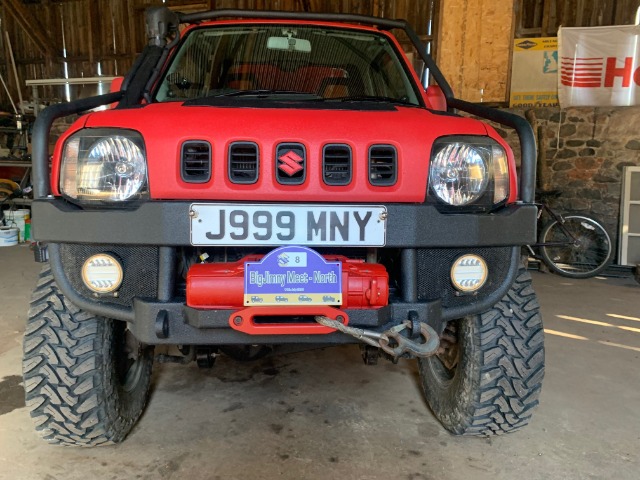

Info pack from Martin arrived today, many thanks. But where to put the numbered rally card?
I will probably tie it to the front bar next to the number plate somewhere for the day. Dont want it falling off or disappearing on the way to the meet.
The sticker i am hoping to get on the windscreen where the rear mirror is, some trial and error needed to avoid the gopro I usually film with.

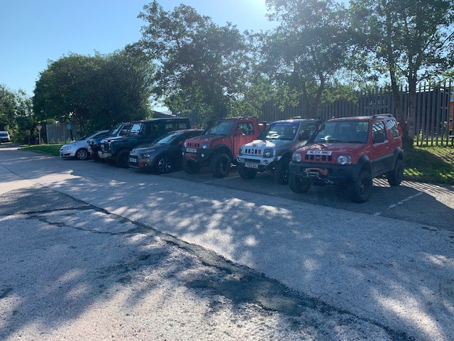

The BigJimny meet at Tong was a good day out. Superb to see so many cars of all different types of Jimny. I had a bit of fun charging around the tracks and the burger van was good too
A massive thank you to Martin and James for organising a great meet up.

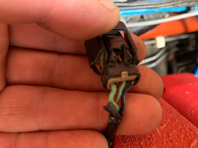

Broke down on the way home, but only slightly. Traced the problem to the trottle position sensor with my handy tablet PC. Turned out the wiring was a bit loose in the plug so fiddled and sprayed a bit of wd40 in to sort that on the roadside thankfully.

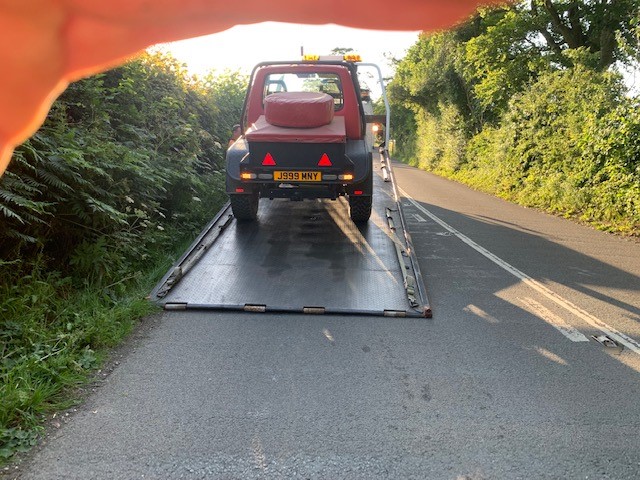

I made it to Richmond and found a garage, but they had no gear oil unfortunately. Carried on and made it to Penrith. Stopped for fuel and it started making more noise. Continued to as far as Sebergham where it started making machine gun noises and wouldnt move

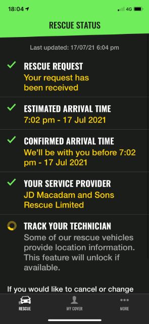

Onto the greenflag app which worked perfectly and even got them to bring a flatbed vehicle first time and in good time too. Quickly loaded up as in a bad place and unloaded off at home by 8pm.

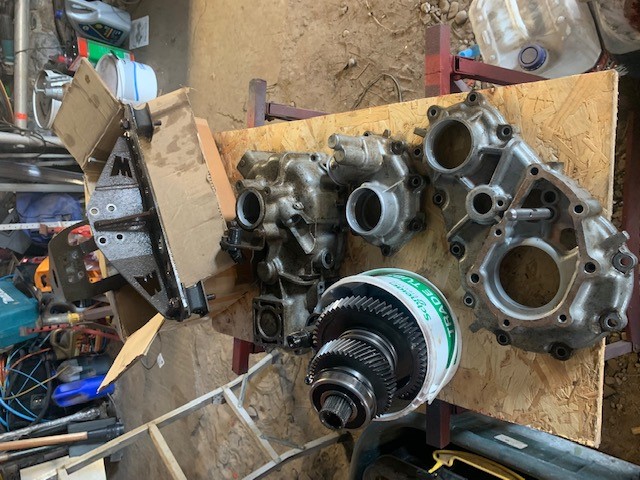

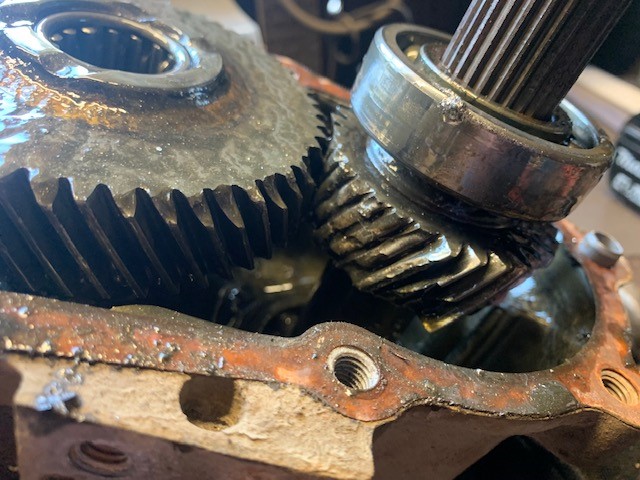

This morning was fish out the box and start stripping it down to see what was wrong. Watched a few youtube vids and looked over Martin's guide (very helpful) and decided that it was within my abilities to rebuild it. Hardest thing was getting the in/out flange nuts off, the rest came apart with no drama.

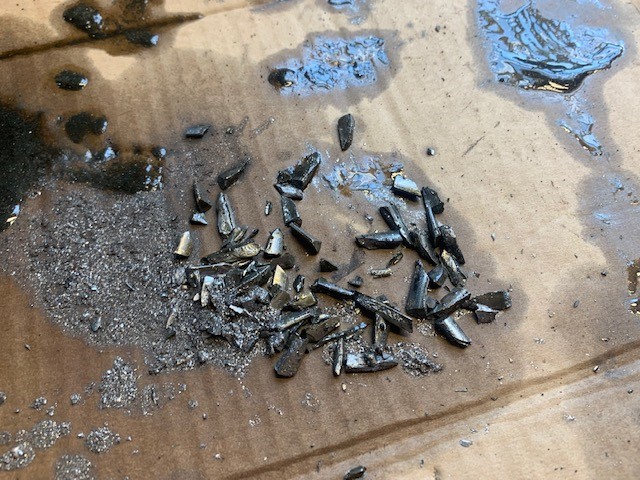

And it was obvious to see that the machine gun noise was the teeth stripping off...
anyhoo... I had been thinking of a 6.4 gearset anyway, but could do without the cost of it just now. Ive contacted James Priestly for a price on the Sumo gearset as it has good reviews. Thankfully the casing is ok.
Stripped it down fully and have given it all a good clean in parts washer solution to get rid of any remaining particles hiding in there as well.
