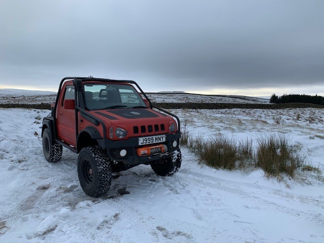

Christmas day outing to visit mam near Alston. Plenty cold enough up there!
and now some time off :woohoo:

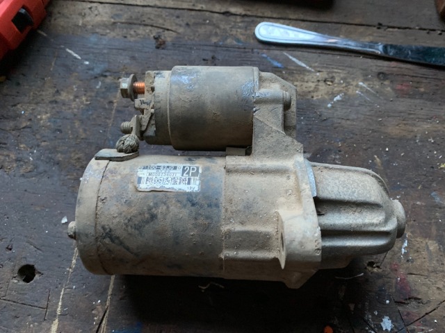

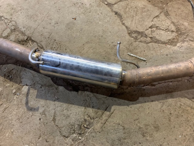

so welded in an extra silencer to the zorst pipe. Was OK, but a bit loud for my liking, so decided to fit the extra small can ive had since I bought the rest of the bits. Makes a small difference, but thats all I wanted anyway.
Then on the test run to the shop the starter packed in and wouldnt respond to the usual roadside repair technique (hit it repeatedly). Luckily a kind passer by gave me a push to bump start it
Back home and after a dig about in the garage I managed to find a spare one I'd kept. Substantially easier to swap it with the bike throttle body setup than the standard jimny manifold too. All in and working a treat.
Final thing I didnt take a picture of was a set of new coil packs. It had been stuttering occasionally for a while. After checking all the usual suspects I took a punt on new coils and it seems to be working so far (finger crossed). Now runs really smooth at idle and nice through the revs too.
Next job is a respray of the bottom half of the doors. When I had welded up the holes from plastics I had used the wrong kind of primer, which then started to flake off in big chunks. Ive been coating any bare metal with some red hammerite so at least it doesnt rust away, but I need to take them off and re-do with the right stuff. Need warmer weather for painting though
