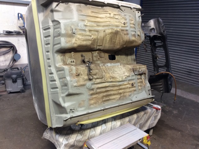

I thought you could put raptor on bare metal? Or am I thinking of linex?
21 Mar 2021 19:36 #233889
Nope, raptor works best onto an original paint finish, if bare metal then its gotta be the acid etch primer stuff then raptor. Ive not tried linex/gravitex stuff, but it might be a better option for underside stuff

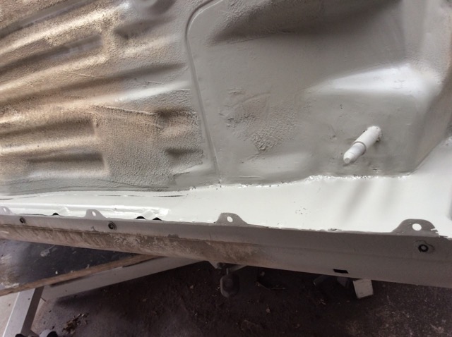

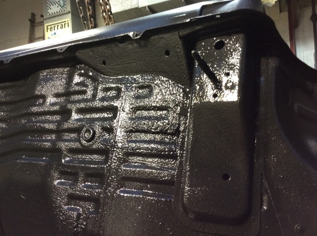

I used Gravitex on the underside of my jimny body. It's made by U-Pol, same people that make raptor. The gravitex has a textured orange-peel finish. I've not used raptor, but apparently it has a smooth appearance.
I just used QD primer on the bare metal (as I had that laying around) and then chucked two coats of gravitex on. I don't know if that's the right way to do it, but it's on now . I should have probably splashed out on some epoxy primer and then sprayed on the gravitex. I've only ever used etch primers when painting aluminium,I couldnt tell you if you get etch primers for steel, maybe U-Pol recommend that in their raptor coating sytem? When I've primed steel with single pack paints, it's usually an alkaline phosphate or zinc phosphate primer. However, Vinyguard Silvergrey 88 would be good for single pack applications as it's used for priming topsides and bottomsides of boats. So many different applications, but as long as you use a correct system of paints, primer, midcoat and topcoat, you can't go wrong.
