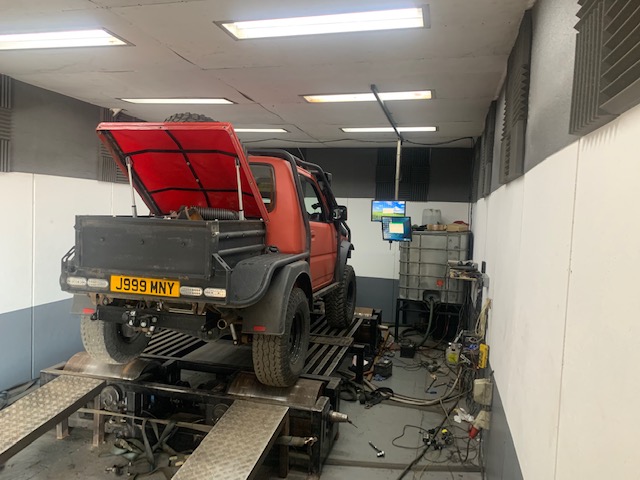

Johnny put a basic tune map from DTAfast onto the ECU and we ran it like that to balance the throttle bodies in situ as well as check temps, sensors, etc. Seemed to be running, if a little badly so we got it in and onto the dyno machine. Strapped it down and Johnny spent a bit of time changing a million and one little settings on the computers. Was going pretty well until we got a few odd sensor failures from the crank sensor, which then got worse as it got warmer. Thats a general symptom of them failing, so nipped home and pinched one from a scrap engine in the garage, went back and fitted only for it to be even worse than the one we were using once it warmed up

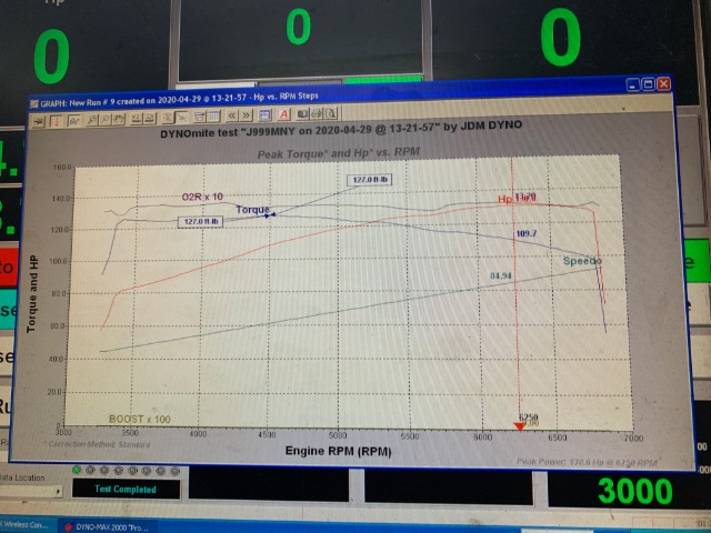

New crank sensor arrived late yesterday so left it until today before going round to JDM dyno.
New sensor fitted and working thankfully! Johnny finished off the dyno mapping (incredibly complicated fuel mapping stuff using the rolling road to simulate load as he went through different rev ranges/loading). Then it was onto a few power runs :evil:
Best we made was 130hp and 127ft-lb of torque. Doesnt sound as much as I had hoped for, but when you take into account the losses from the huge tyres and complicated drivetrain its not bad. Certainly makes a difference when you drive it, much smoother power and much more power at any rev range
happy customer!
Dyno graph:
