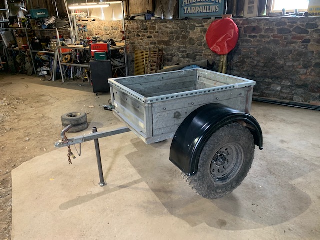

More fiddling with the trailer today...

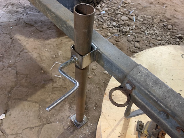

Made up my own version of a leg for when its detached from the car out of bits from the scrap pile:

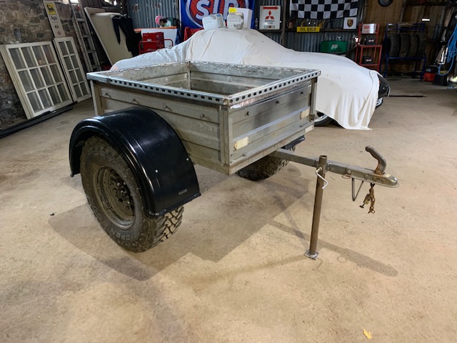

Then welded a load of unistrut onto the top edge of the sides to strengthen and straighten them. I used slotted strut to give me loads of potential tie-down points along it
Thinking of other uses for this slotted strut now ive got some to play with :whistle:

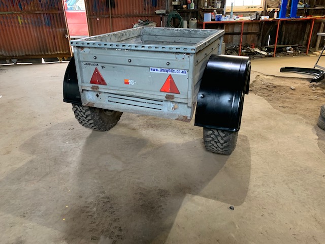

Wheel arches on too. Trimmed some cheap ones from ebay down and mounted with some simple L steel welded to the trailer chassis. Pretty pleased with it:
Ive ordered some Raptor paint and primer, awaiting that one however.

Looks cool mate
If you still have your vac former you could form some light pods
fitted on top of them arches

That really is looking like a mini penman now! Absolutely love it but I do have a bit of a trailer fetish.
