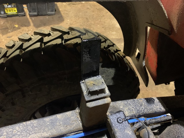

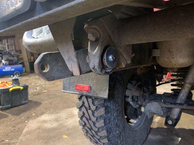

Snagging day. Few things were wrong or annoying.
First was that the trailer/tipping body had moved slightly to the passenger side and the cover had snapped at a corner weld. Corner weld was easy. Moving side to side was more tricky. I have drilled and tapped large screws & washers into the ends of the pin that goes into the bearing to stop them sliding out:
And made up some angled guide rails for the bed to align with its rubber stops properly:

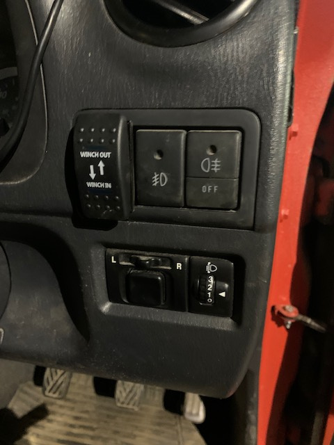

That sorted out the wrong stuff, next was the annoying winch controller. Its a winchmax one and came with a wireless remote that can also be plugged in (e.g. if battery goes flat). The reciever for the wireless part of it is not waterproof (so winchmax tell me). Its located within the solenoid box (the solenoid is waterproof at least). Obviously mine has got wet as it no longer works. Plugging in the lead is a bit of a pain as the solenoid box is under the bonnet, near the airbox. A cheap two position retractive switch was bought from amazon and wired into the dash blank beside the fog light switches.Fitted with a little filing to the inside edges It doesnt match in at all however, but works well for now:
I do remember someone on here found a supply of matching switches for the Jimny dash, but cant remember who???
