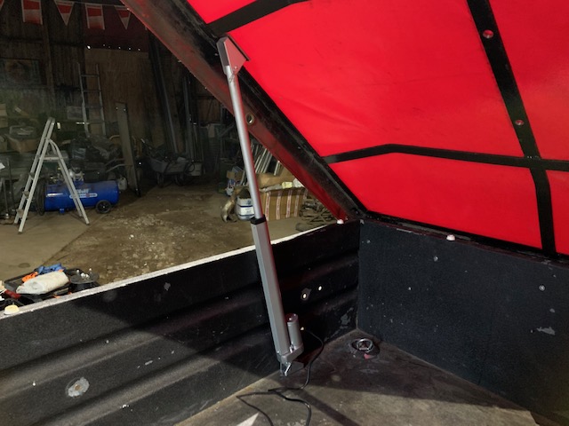

With having the spare wheel mounted on top of the load bed cover it was getting a bit heavy to work by hand. I was going to source some gas struts and use them, but have gone for linear actuators in the end. This was for two reasons; 1) to automate it electrically and 2) security as when its down theres no lifting it up by hand. The actuators themselves worked out cheaper than the gas struts, but more expensive by the time I added in the control kit (by about £60).

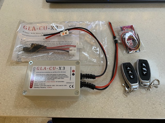

control kit:

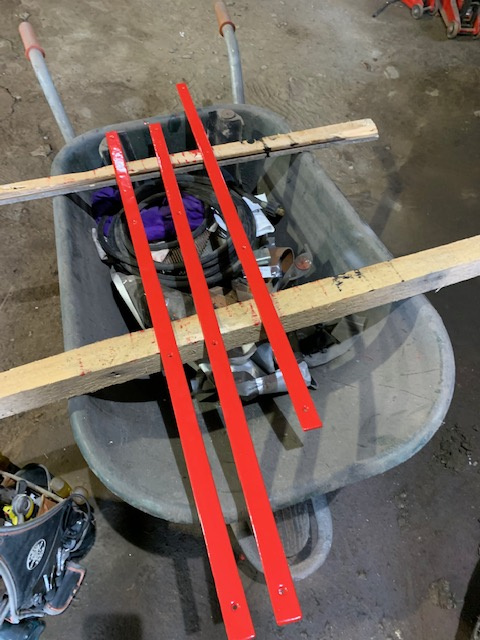

Ive messed about mounting them up today and strengthened the hinge mounts as they were poor. Working well even with the weight of the spare tyre, if a little slowly (that could be the old alarm battery im using to test it however). Just need to wire it in permanently and put the spare wheel back on. There are also some steel flat bars over the sides of the tarpaulin now to stop it being lifted off easily. The wireless control kit needs to go in the cab somewhere as its not waterproof and I want to wire in a backup manual switch incase of remote control failure.

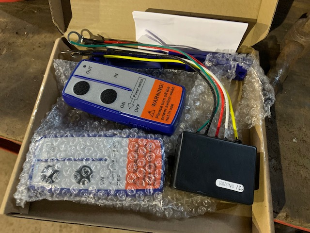

The other wireless thing that the postie landed with was a new set of remotes to go on the winch...
Winchmax wanted about £45 for a new remote and reciever. This came from amazon for £12.99. Obviously its not as sexy to look at as the winchmax ones, but will do for my needs happily enough

I have those winch remotes. Other than there being a very slight delay in operation from pressing the button, they're great.
I can live with that and you get 2 in case one breaks or gets a flat battery.

Having got them wired in now, I see what you mean. Slight delay to go and it seems to go for a minimum of 1 second, which is sometimes more than you want. However I have the dash switch if precision is needed. They were easy to wire in and I put the reciever part in the dash behind the switch previously fitted to keep it dry.

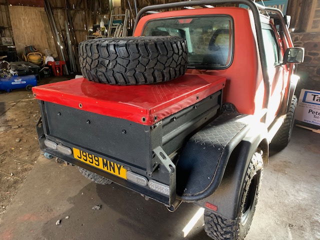

After that it was putting stuff together and finishing off the rear load cover. I had been slowly applying a coat a day of paint to the bits of metal getting bolted onto the cover, put it all together and pretty pleased with it:
