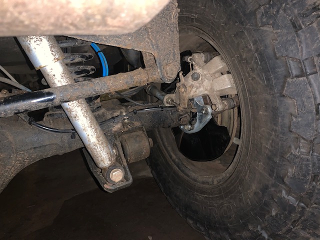

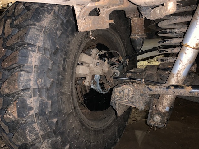

Floating rears finally finished this weekend.

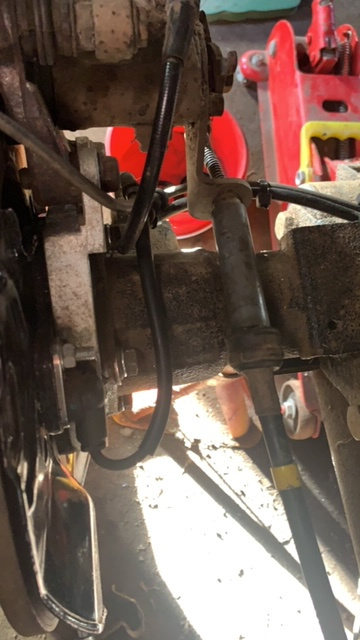

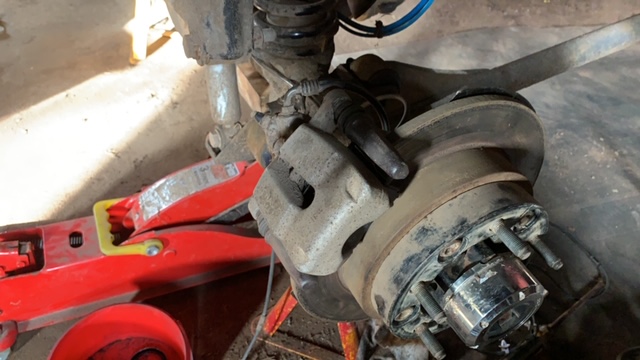

I picked up some new brake pads for the golf calipers and noticed they were the same as the ones for the renault brakes I had been using. Surely the renault caliper wont fit on the golf bracket then? :ohmy: Yep she does and fits well too :lol: :woohoo: That saves a load of work bleeding brakes and making new brake lines thankfully...
And the handbrake works just as before:

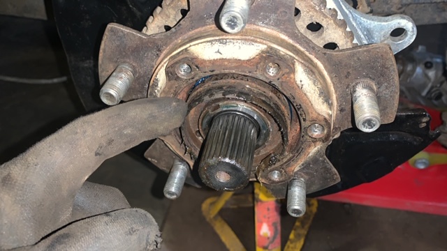

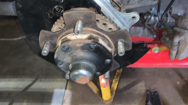

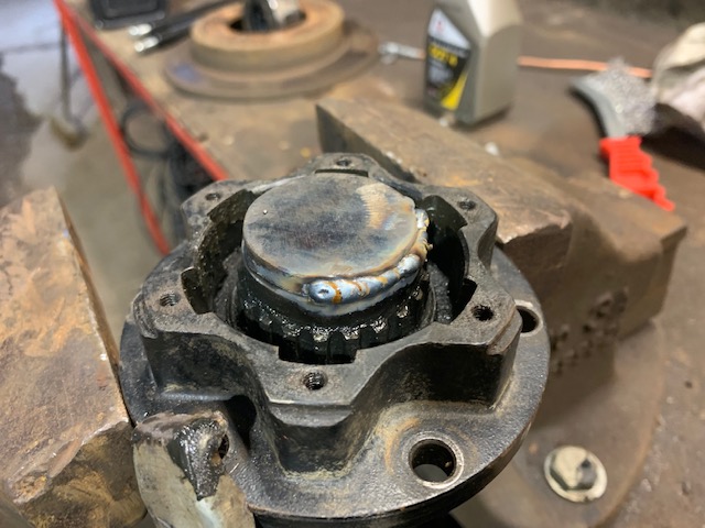

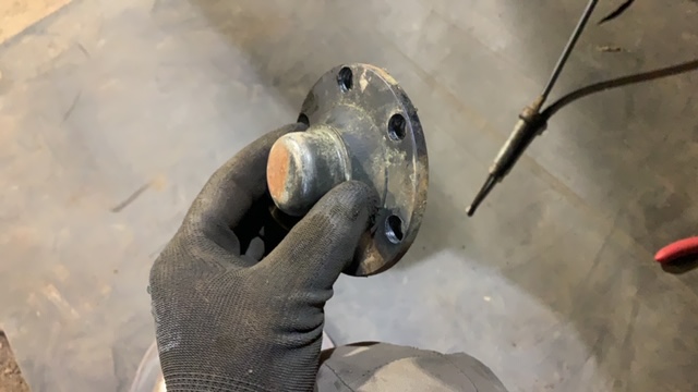

Next was the hubs. Discussions about this with various people highlighted that the shaft is able to move in/out of the diff by a given amount. I didnt want the shaft to be able to move out as it introduces the risk of shaft damage.
There are two options at this point. No.1 is to use the vitara fixed front hubs and cut down the bearing retainer nut a bit:
Cut the edge of the nut here to allow the vitara cap to fit back fully:
Or No. 2, my way, which is to weld caps onto the internals of the manual hubs. Wasnt sure it would work or cause issues, but it seems ok so far from the test drive...
Then it was fiddling about with the ABS sensors. I had bought some cheap ones for a very early jimny off ebay and fitted them. The go into the axle stub in the same way as they would on the front of the car. A little bit of grinding to the axle end plate is needed to make room for the sensors. I unpicked the wiring from the new parts plugs and fitted it into the old wiring connectors so it looks factory and works properly. Forgot to take pictures of that of course, but no light on the dash is a good sign :laugh:

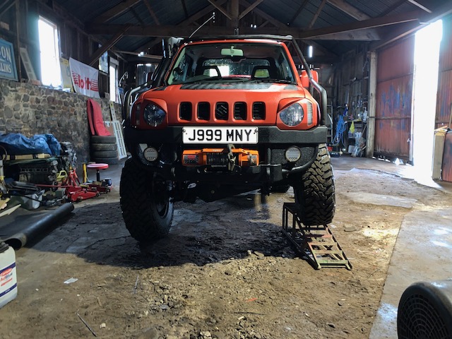

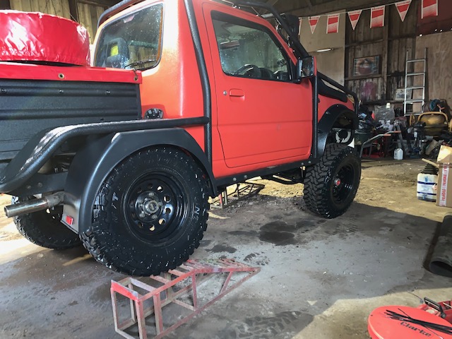

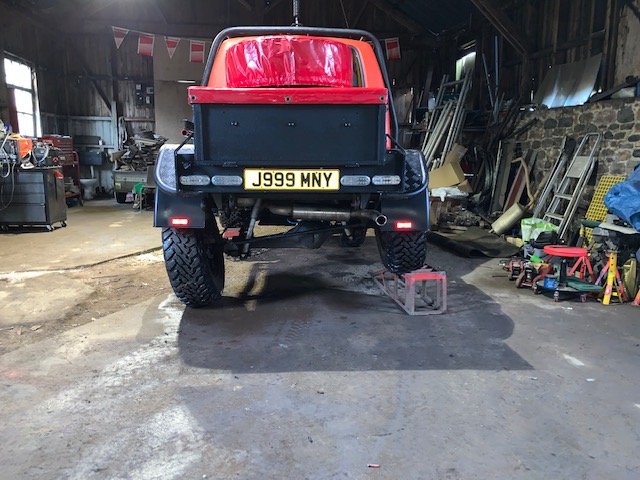

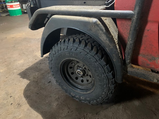

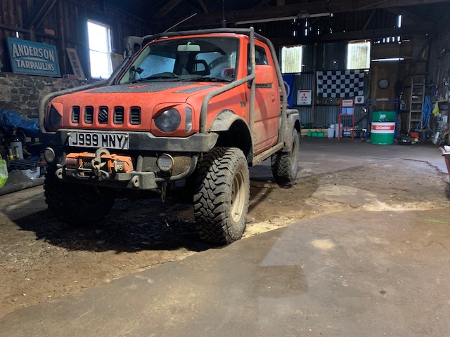

So yes, wheels on and off out for a test drive which worked well and no funny noises. Back for a wash and a quick bit of flex testing in the garage on ramps (to check the brakes dont hit anything on flexing). Its working well now. Got up the ramps in lowbox 4x4 without the lockers or any wheelspin so I presume theres more flex avaliable
