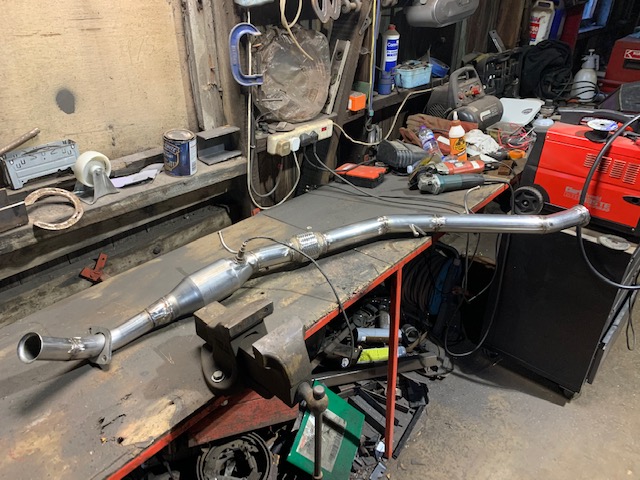

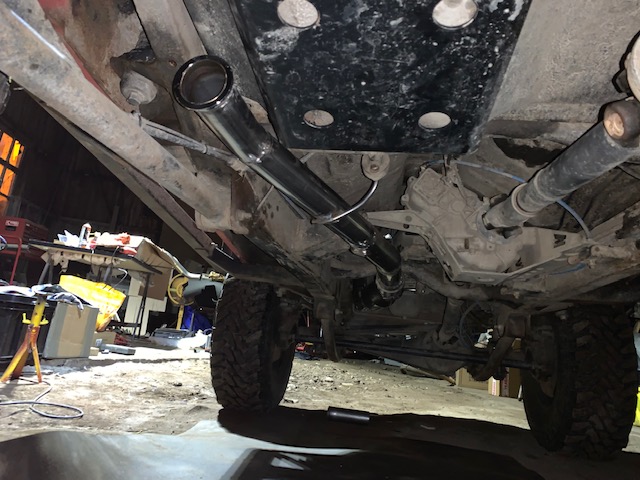

Zorst coming along. Started welding up the joins only to run out of stainless mig wire. Cue a trip into town for more, only to run out of argon gas about half an hour later
Managed to get the front bit welded and a joining flange fitted to the end. Fitted it onto the car and reset all the engine management light things from it having no exhaust sensors and started her up. Very noisy without the back end box on but no EML
(I had previously had problems with the 4-2-1 manifold on a standard exhaust causing sensor problems).

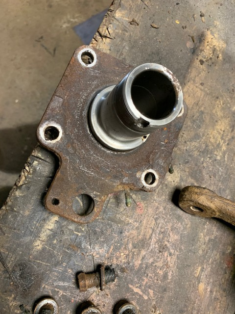

Then started messing about with some front hubs to get my head around a floating rear setup. There is a kit made by a russian fella which adapts it to use front hubs.
the kit:

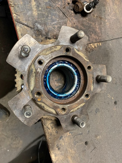

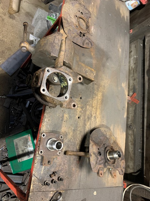

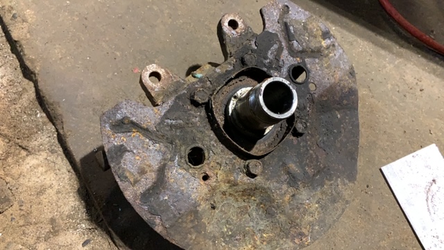

and you take parts from the front hub to make it up for the rear
and that means that you I only need to carry one spare part for the next time a wheel bearing goes:
It also means that (if i use manual hubs) its possible to make the car run in front wheel drive only (e.g. if the rear diff blew, just take the rear prop off and switch off the back manual hubs).
the kit:

Does having a floating rear not introduce the issue of needing custom shafts and therefore the problem of a readily available replacement if one dies? Or are the shafts donated from something else that happens to have the correct splines and length? Sounds cool though either way.
