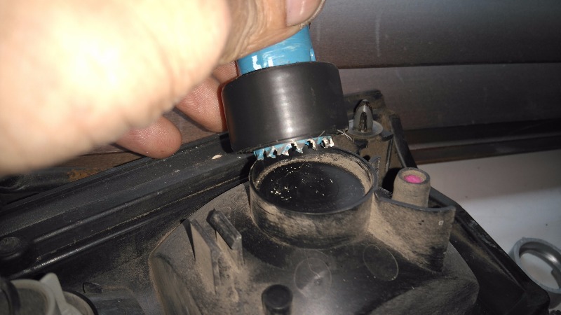

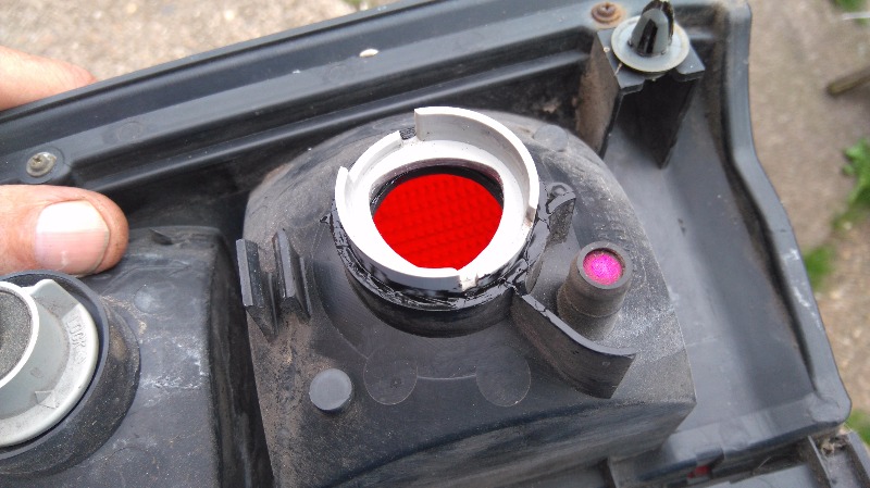

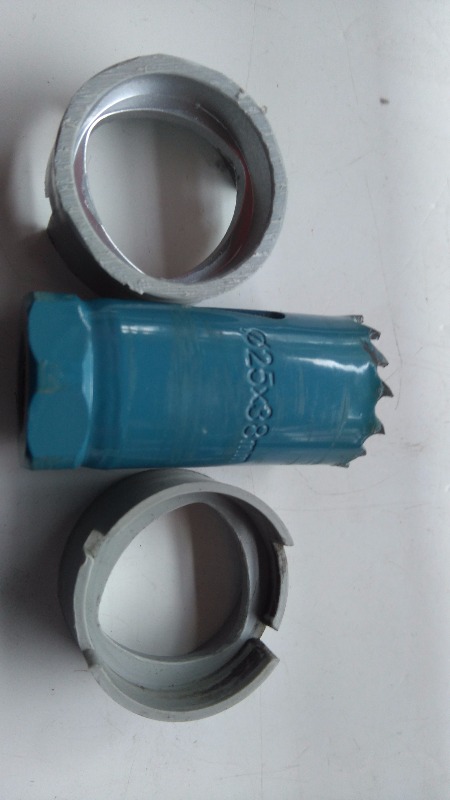

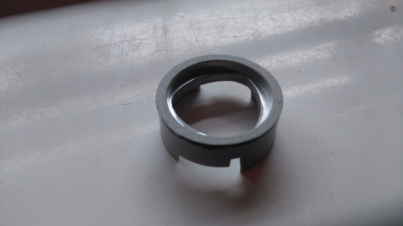

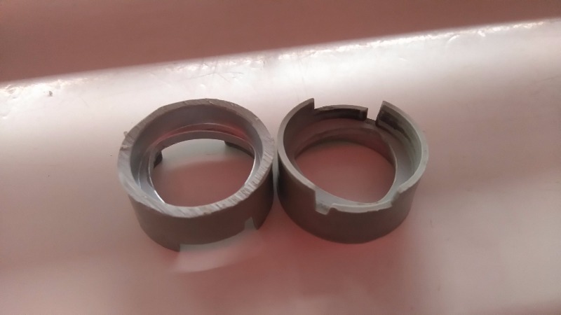

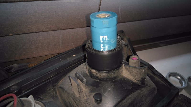

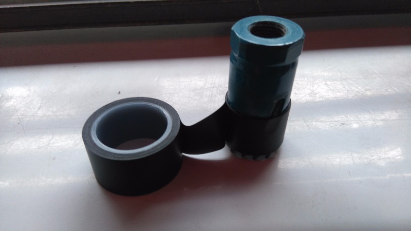

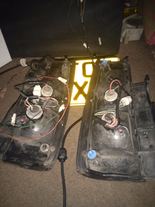

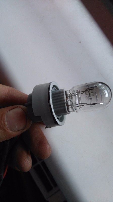

i used haksaw and cut the stop/tail bulb holder off original cluster
sanded flat 15mm overall length
i used hole saw 25mm and used tape to centralise
i think step cutter would be easier
then super glued in position then used silicone for extra seal and strength
Jack
Jack

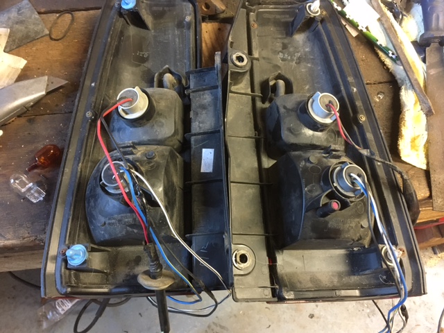

Things have started arriving now for the upper rear light conversion

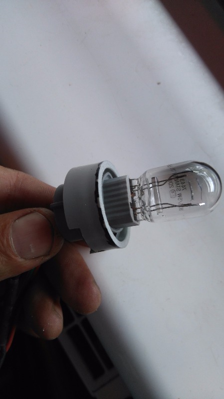

I went to scrap yard today and managed to get a rear wiring loom from a Liana for £5, I cut this up to give me the stop/tail lamp, and it also has the orange indicator bulbs that I'll also need, so that was a bonus! The finished result....
JackonJack - I just filed out the original holes to make the shape (rather then cutting and gluing), and the lamp holders seem secure enough - time will tell.
I have also stripped out the plastic side panels inside, ready to start work on it. The inner wheels arches will also get a quick waxoyl before I put the side panels back on, as surface rust is appearing at the welded joint. I have decided to put the trailer socket inside (mounted on the plastic side panel) this will keep it dry and less prone to damage. My small trailer has a long lighting cable, so I can just feed this through the rear door rubber seal when I need to tow.
Phil
Phil
