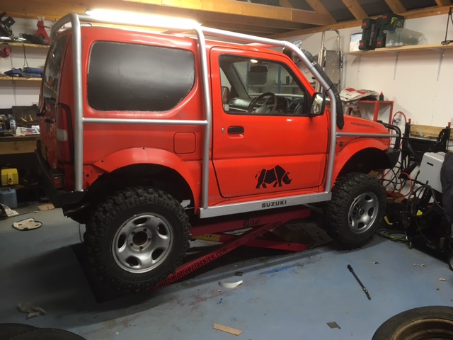

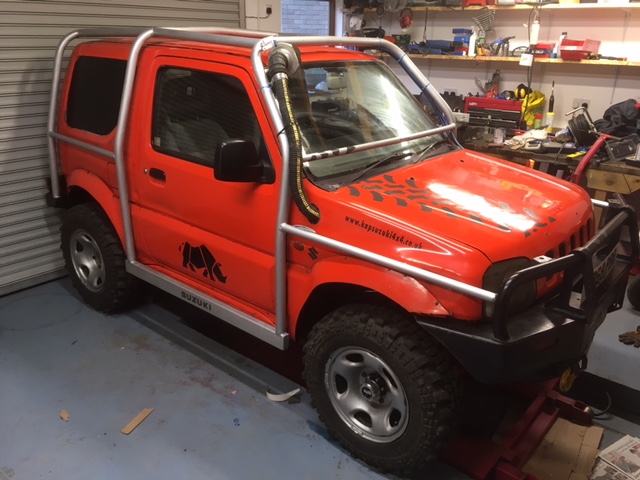

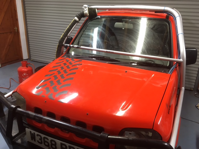

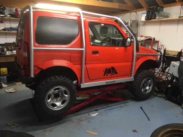

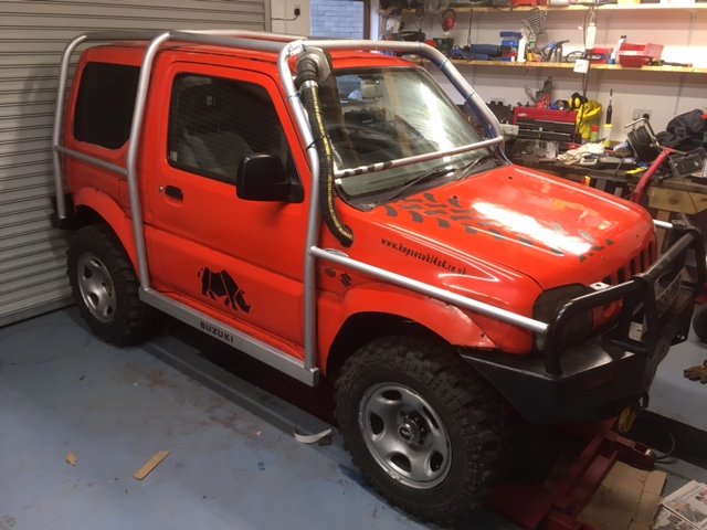

Work has been ongoing, but mainly on the visuals. I looked it little dark and dumpy so a few days with hammerite (in freezing conditions outside) and some ebay stickers have updated it.
On the scissor ramp just finishing off
Tread sticker - I have since altered the front as I didn't like the sharp cut off of the sticker
And finally back on four wheels
Phil
Phil

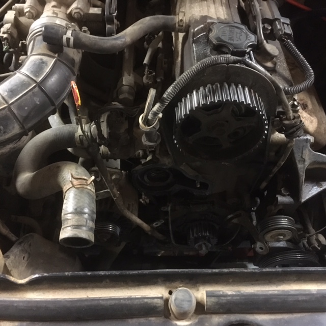

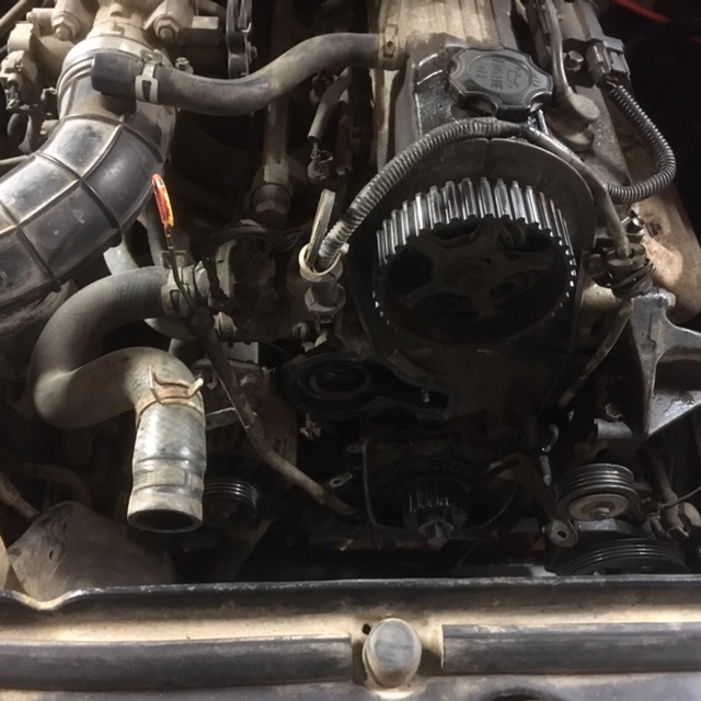

Arghhhh, bloody jeep. Today was a quick finish off of the front suspension and get it ready for the trial on Sunday. I fitted a CB which all went to plan and was quite enjoyable, then decided to change out slipping alternator belt for a new one. Once I stripped out the belts off, I noticed the water pump was completely goosed (funnily enough not leaking) but the play in the shaft was massive, hence the alternator belt slipping. Phoned around at 5pm and managed to get a water pump sourced for tomorrow, but I had the strip down the entire front of the engine including taking the timing belt off
Now I've gotta get it all rebuilt tomorrow night, if I want to go trailing on Sunday.
