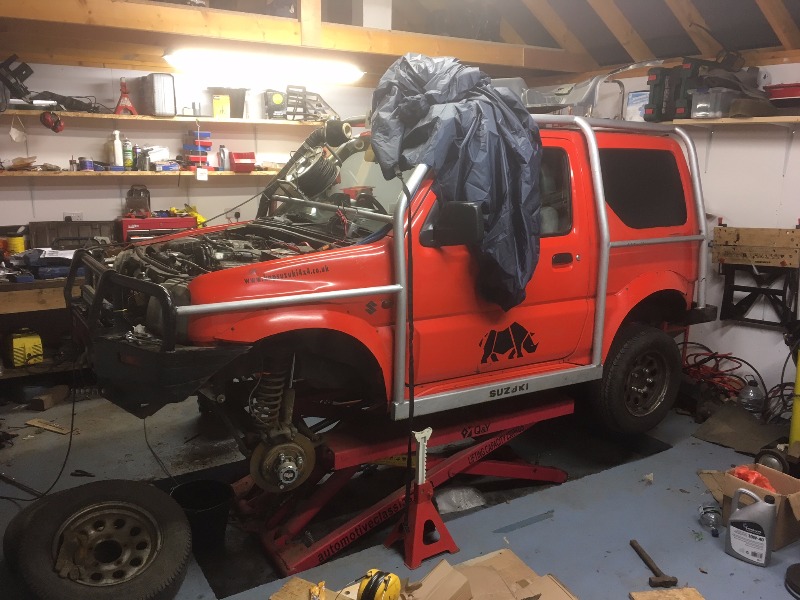

IT LIVES
I had it running for a few minutes, and seems to be smooth running so far. I have stopped now with the engine conversion and moved my attention to rebuilding the front axle so I can take it for a test drive. I swapped the drivers side bearings, helped massively by having a 20T press. So next its passenger side, which should be fairly quick now I know what I'm doing. Then bolts the wheels on and get it out on the road to get properly up to temperature and look for leaks / issues.
Engine ready to install
Ongoing work...

Jeez, this software in doing my napper in....
1st pics was the engine ready to fit, 3rd pic was a new Rocklobster box.
Phil
