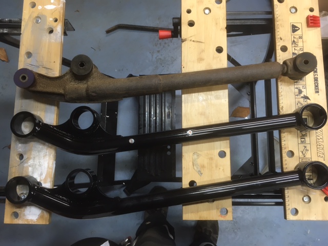

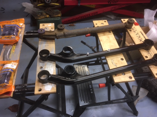

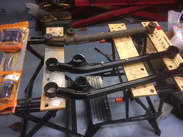

Today's job - Change out the castor corrected radius arms for Jimnybits ones. The original ones I think were quite old and probably for a +2" lift, which was bowing the front springs, so I updated them to Jimny bits suitable for a +3" lift and new superpro bushes to compliment them.
At the same time the shock absorber lower mount had sheared off on the last green lane day, so I wanted to strengthen these. I started with Jimnybits front shock guards, but as these use the original mounts, I had to scrape off the plastic coating
and then weld in some angle iron to pick up on the lower shock mount.
I'm hoping to get it all fitted tomorrow
Phil
Phil
