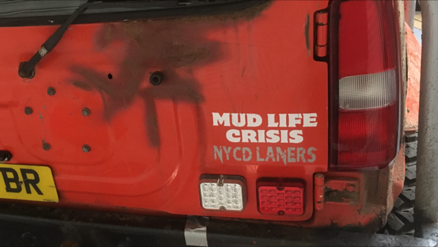

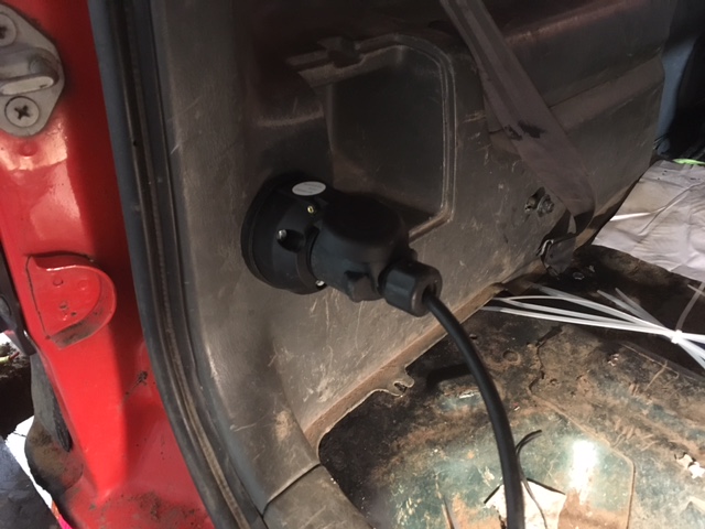

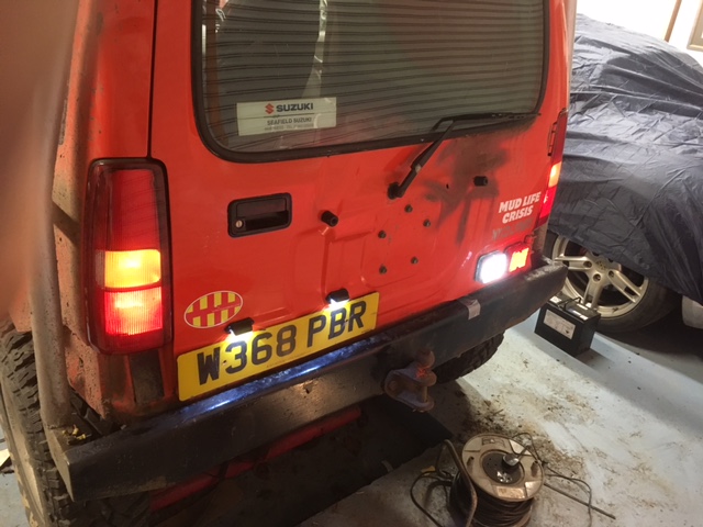

Last night and today I have been modifying the rear loom to make it work on the rear upper lights, it was a lot of work, but worth it and it tidies up the back end some what. I now LED number plate, reverse and fog lights as well

Before
Everything turned on
Towing socket safely in the rear (I also added an audible alert)

Rear Fog / Reverse
