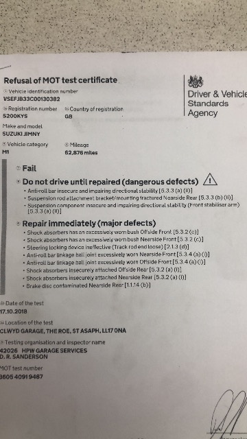

Ah... epic fail
Three of the eleven faults are because the anti rollbar disconnect was not bolted up...
Zanfi panhard bracket has a crack / fracture in it
Adjustable front panhard rod nut is loose
Front shocks are AVOs... hope the bushes can be changed?
[strike]Track rod end loose? Haven’t spotted that one yet, in Post Office today but S200KYS is parked outside[/strike]...
Edit: just the lock nut is loose...
ARBs droplinks feel loose as it’s disconnected
Rear shocks loose? Repositioner brackets?
Oil leak from axle over brake disc hopefully just an oil seal?
Off Friday this week, so have a work list
Ah... epic fail

Wow. At least they are fairly simple fixes.

Simple fixes for a man of Dave’s ability
