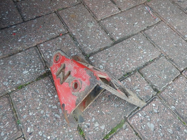

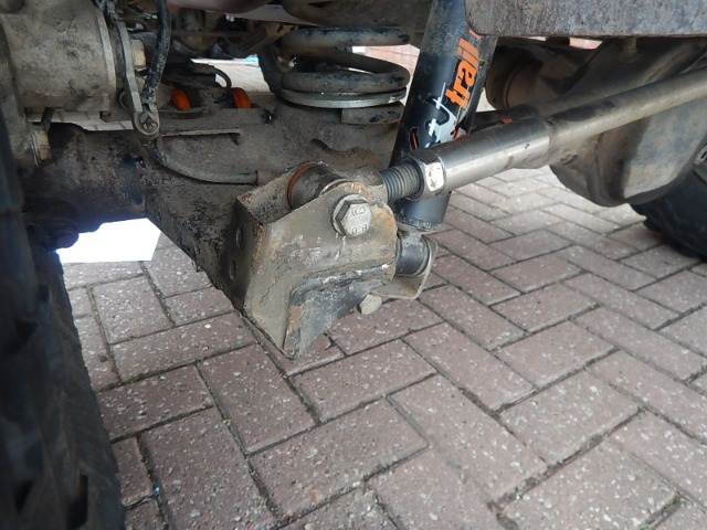

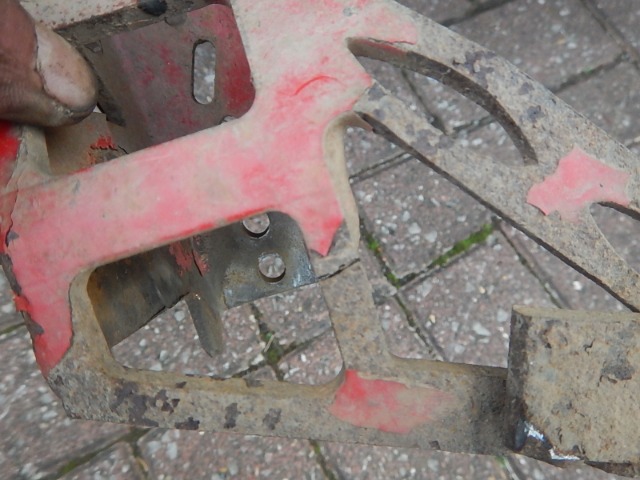

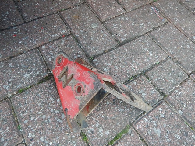

* Suspension rod attachment bracket / mounting fractured Nearside Rear -
Indeed the Zanfi Panhard Rod raising bracket had a fracture in it...
So I took it off...!
And wound my rear Rockwatt adustable panhard rod out to suit

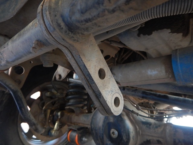

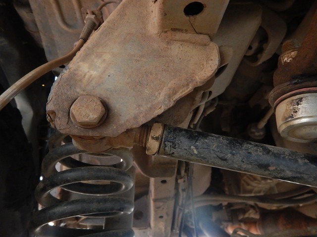

* Suspension component insecure and impairing directional stability (Front stabiliser arm) -
That translated to the lock nut on the front panhard rod was loose!

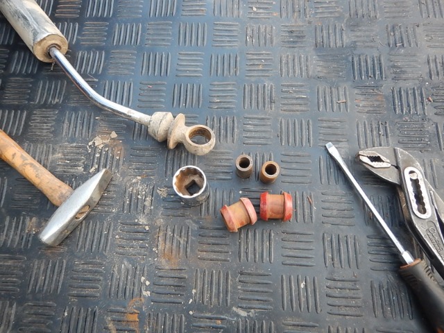

* Shock absorber has an excessively worn bush Offside front
* Shock absorber has an excessively worn bush Nearside front
Indeed, both bottom bushes on the AVO adjustable shocks were shot
So...
Rummaged through the garage and found the old rear bent AVO shocks (when the axle wrapped and took the piston rods out!) and stole the bushes from them... proving you should never throw stuff away, it will be usefull one day

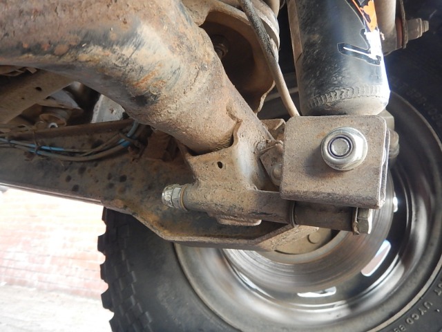

* Shock absorbers insecurely attached Offside Rear
* Shock absorbers insecurely attached Nearside Rear -
Hmmm, would have disputed this one, as they are in shock repositioners to let them move freely with the axle's articulation, but no point arguing so I nipped them up for the re-test, and then loosened them off straight afterwards

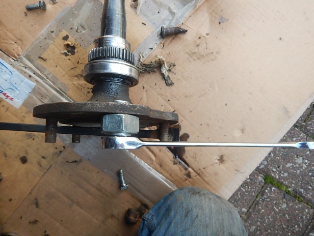

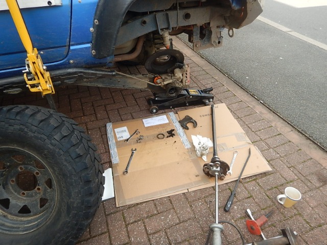

* Brake disc contaminated Nearside Rear -
Ahhh, slight oil leak from the axle making the disk a bit oily... an easy fix then, or so you would have thought?...
Wheel off, disk caliper / bracket off, pull shaft and replace the offending oil seal?...
Nah...! :S

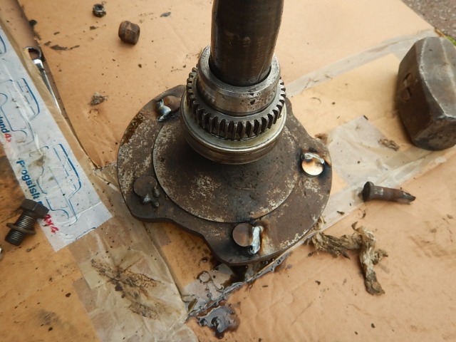

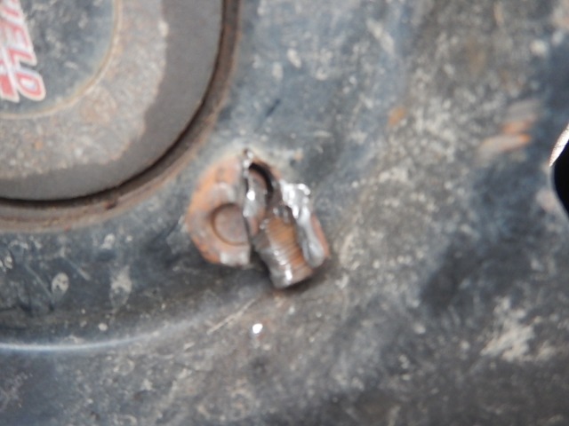

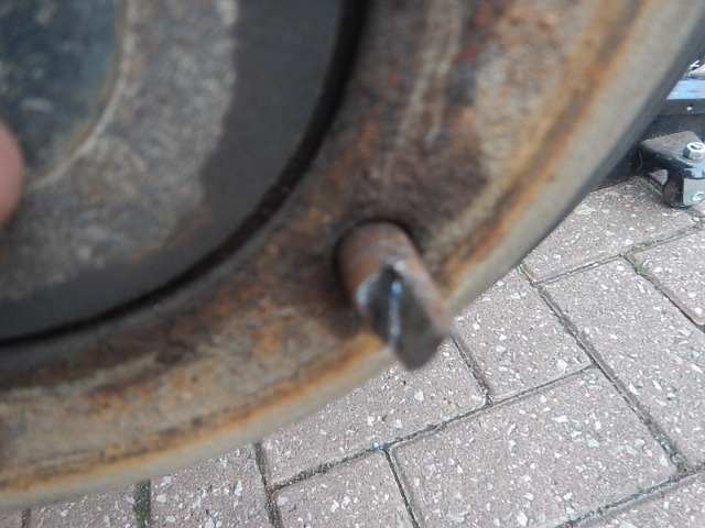

One of the wheel studs was turning in the TG rear HD shaft's flange, another one, I've had a different one do this too!
So it was either weld it in-situ or forceably cut it off!
Enough to get the wheel off and later replace the stud...
Shaft finally out, damaged (whilst fitting by the look of it) oil seal replaced...
New wheel stud pulled through...
And that and the other three remaining un-welded studs then welded to the TG shaft's flange to stop any of them turning and stripping their splines in the flange again...
Reassemble, and submit S200KYS for a re-test, and passed... all history now, but as said at the top of this post, re-posted for the integrity of the build / use thread... and might help someone out there one day?
