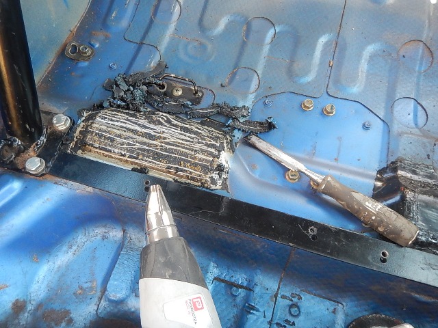

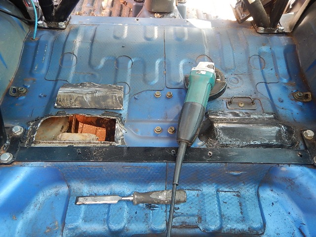

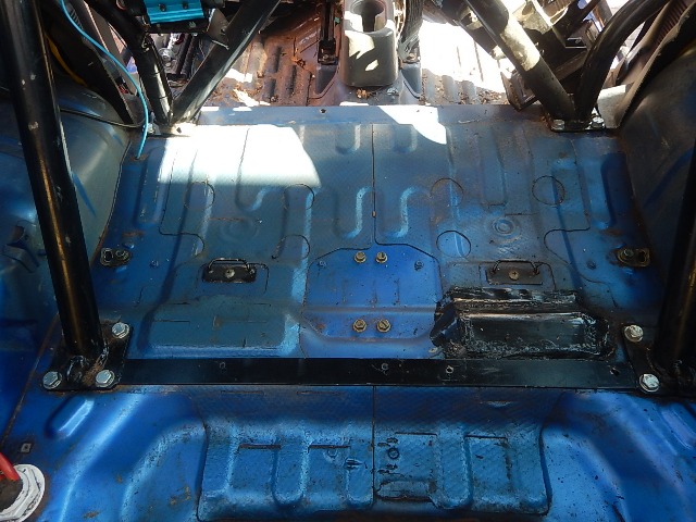

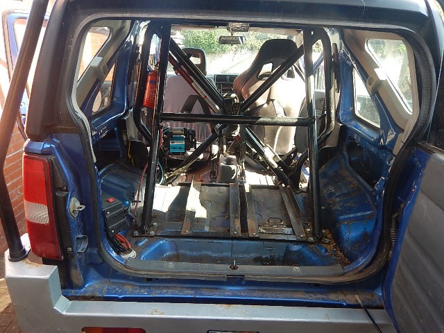

I fixed the rear shock today...

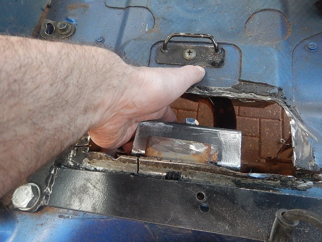

I emptied everything out of the Jimny...
And removed the rails for my two storage boxes - tools and spares

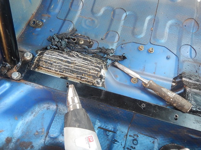

I stripped the tar sound deadening with a hot air gun and a chisel

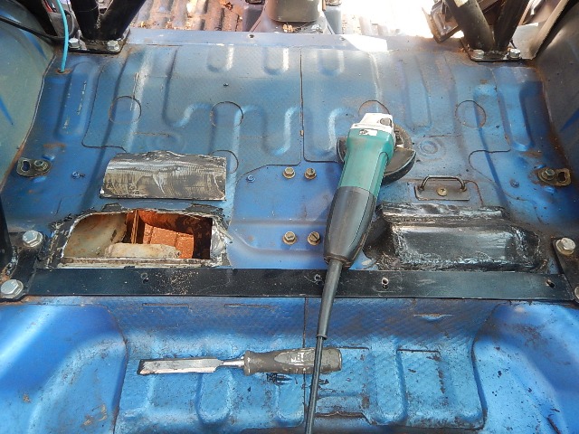

And then cut a matching hole in the offside, I did the nearside a few months ago! :lol:

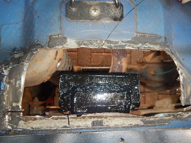

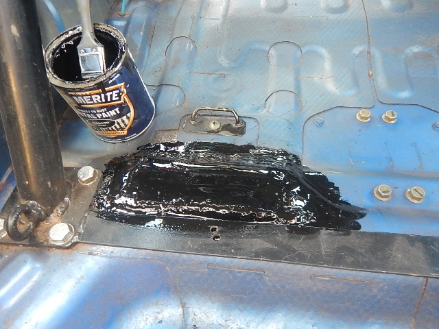

To be able to make a new mount to weld under the old failed one...
And the painted it with Hammerite before...
Welding the patch back into the floor and painting that too...

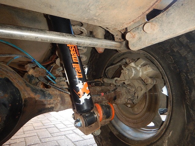

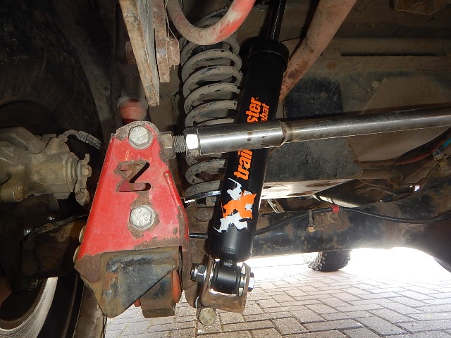

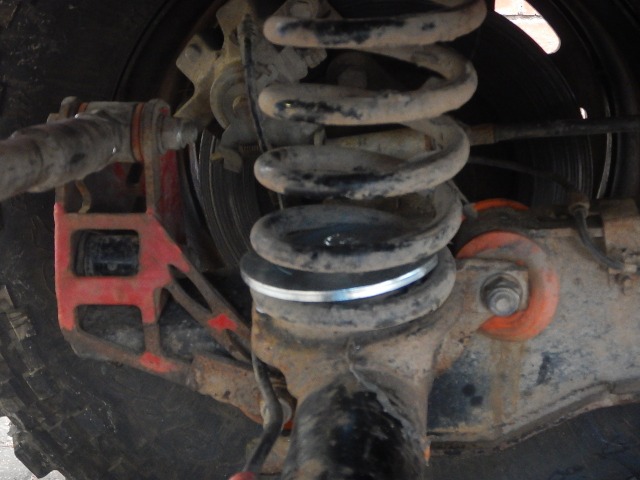

'New' Trailmaster Combat shocks fitted

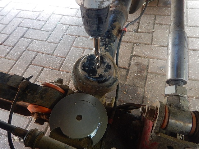

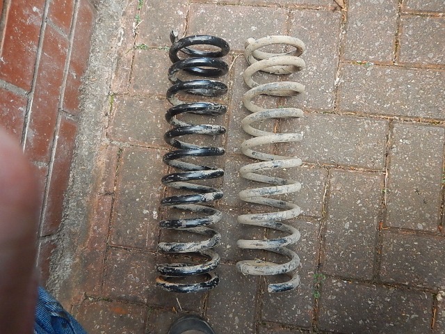

Drilled the spring seats and...
Swapped the rear springs from Mercedes saloon ones, back to JimnyBits front diesel +4" springs...
And secured them with some spring clamps.

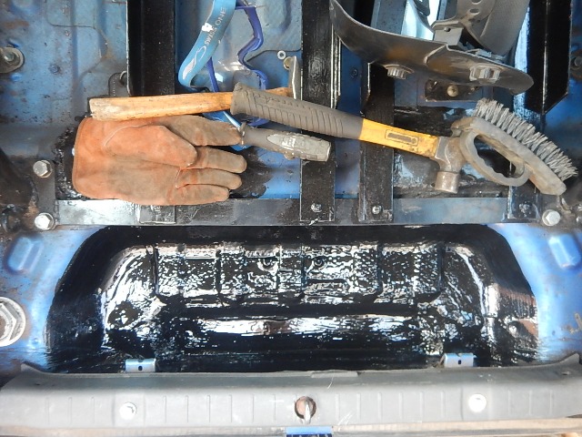

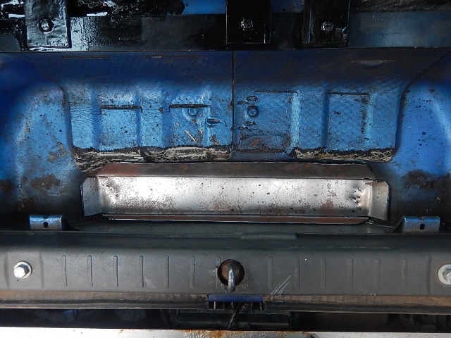

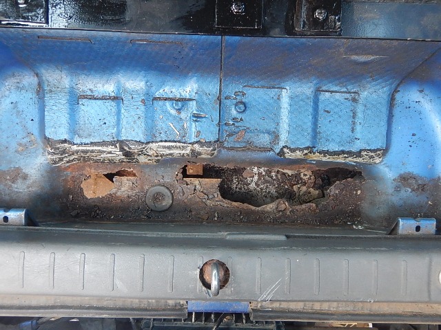

Whilst doing it, I coudn't help but notice a small hole in the jack well, so I had a pick at it, and it got bigger and bigger
So I made a trusty cardboard template. and then transferred it to steel sheet...
Welded it in and the hammerited it all again...

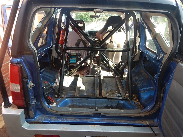

Just need to sort, check and reload everything back into the Jimny, now I've hoovered and cleaned the interior...

Definitely not a new thing as they've been hanging round in the Bits4Vits stock for years after being returned by a customer (for squeaking if I remember correctly) when I used to deal with trailmaster (by Maas, the German company not the US one of the same name).
From memory they were a competitive range, to 'combat' cheaper brands...?
They just happened to be the same length as the battered ProComps I took off... hmmm, or actually, they fell off themselves?! :woohoo:

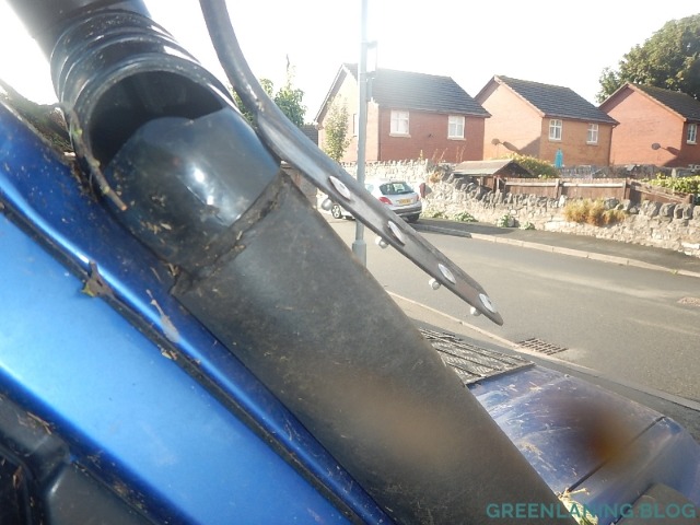

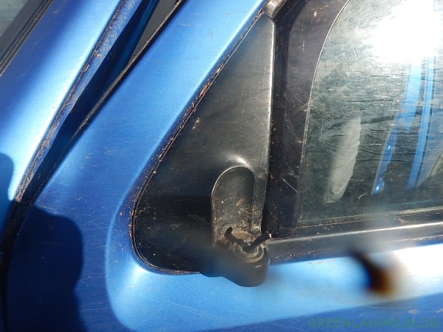

A tree claimed the passenger side door mirror...
And some others gnarled my snorkel guard too!
