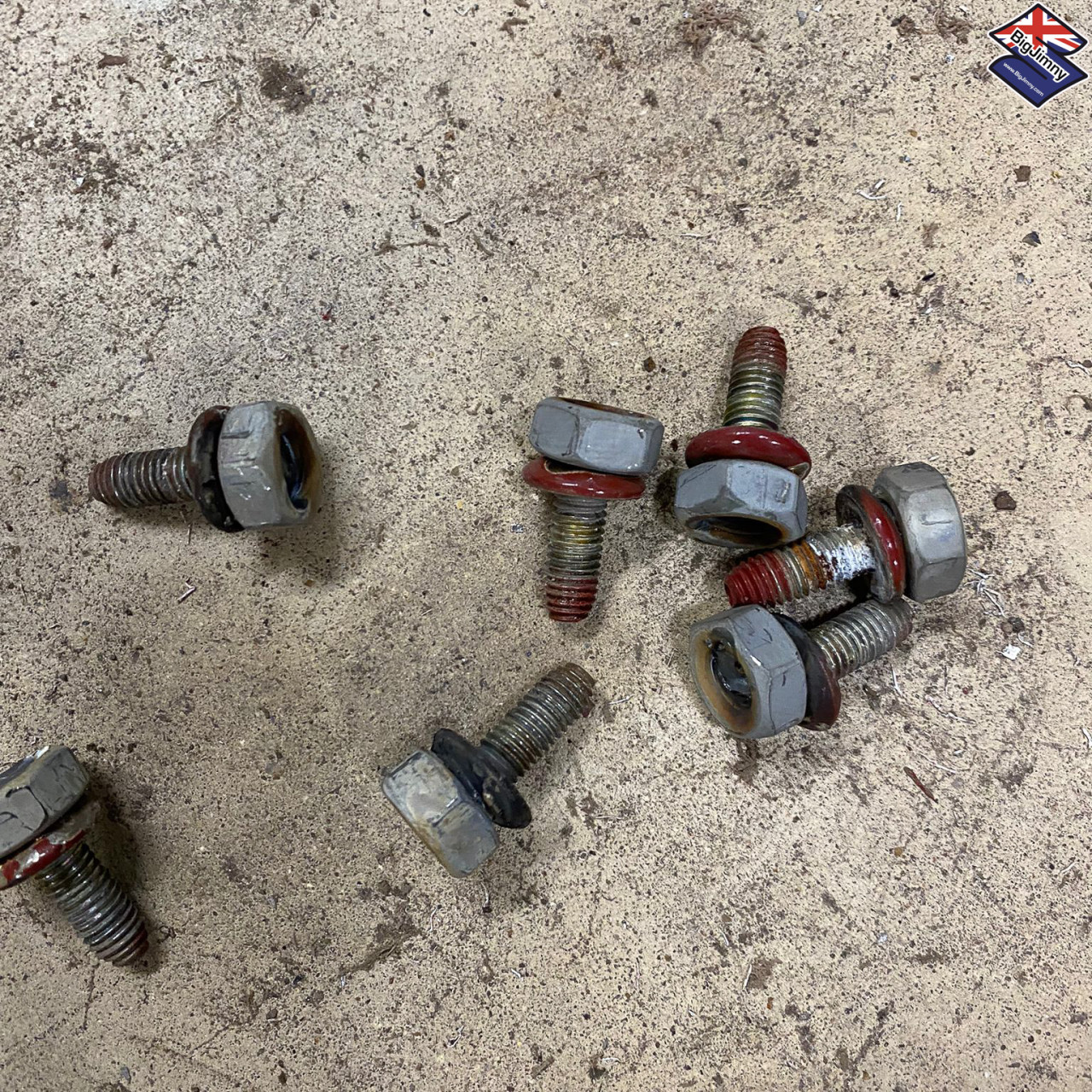

With the bolts in full retreat, Winchfield Engineering had a first look at the body panels.
