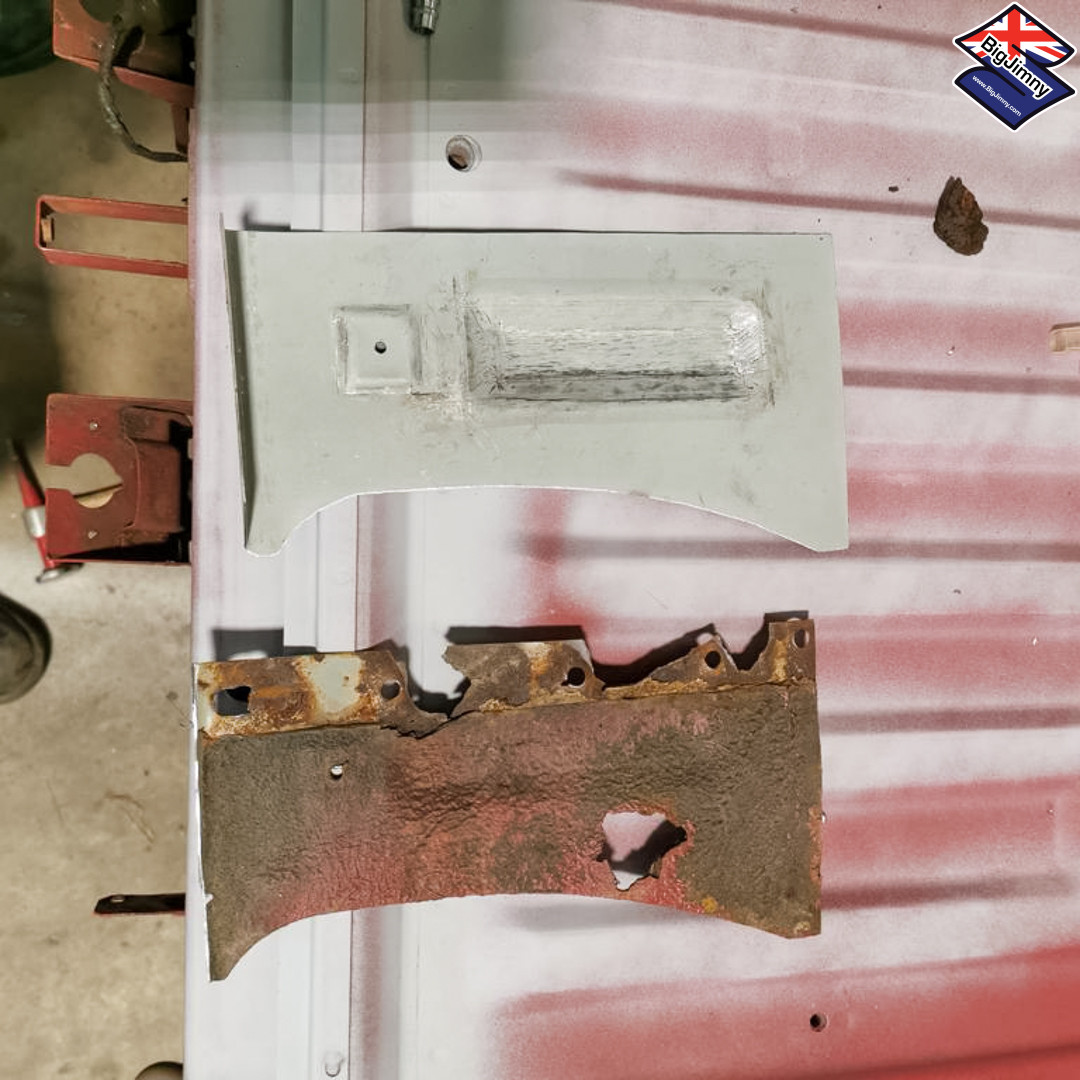

The restoration has turned a corner, things are starting to go back together rather than come apart.
The welding has started with patching/repairs of holes.
NOTE: These pictures show work in progress, not necessarily completed,
The most common place for corrosion on both SJ and later Jimnys is around the body mount behind the front seats.
The bodywork here is a sandwich of steel panels. Here the top panel has been cut and removed to reveal the rust in the panel behind which has then been cut out and removed (you can see the body mount!)
The holes are then plated over, closing them up.

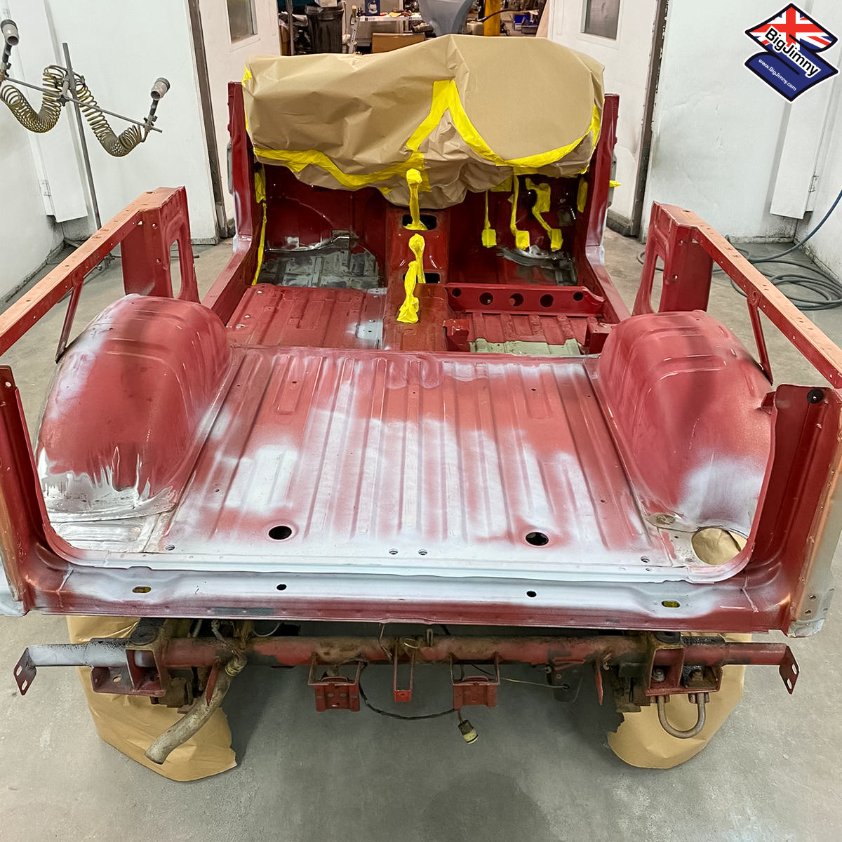

Lil Red - SJ restoration - Patching completed
Processed-WhatsApp-Image-2023-02-27-at-15.23.071
 Work is really progressing this week over at Winchfield Engineering. The welding patching to the bodywork is complete. The welds have been ground back smooth and now a protective coat of epoxy and Cobra (for the undersides) is put on in the paint shop to protect the bare metal until the full painting starts.
The next stage should see the wings being re-fitted.

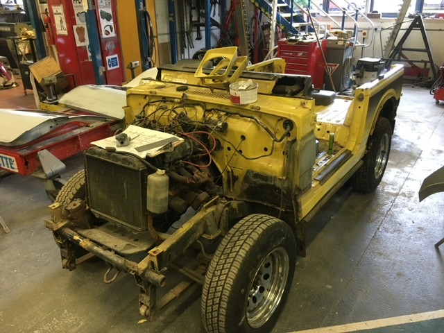

Another SJ Build - Sam's Yellow SJ - An update
Sam has sent in an update on the progress of his SJ. Many thanks Sam!
These SJ restoration projects are proving popular at the moment, if you have some work in progress why not send in the details to show them on this website?
As you can see, the body was stripped of all major components and then removed from the chassis.
In Sam's case this was to assist in a planned upgrade from the 4 speed gearbox to a 5 speed along with a general rebuild of the transmission.

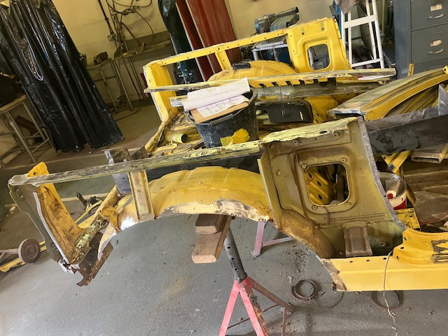

IMG_5324
Sam Emery spotted the start of the work on our SJ and sent over a few pictures of his own build which is starting at the same time as ours.
