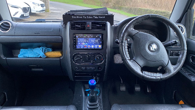

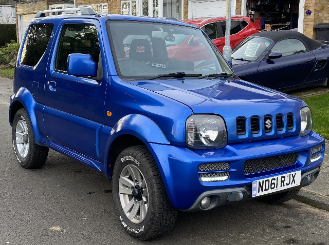

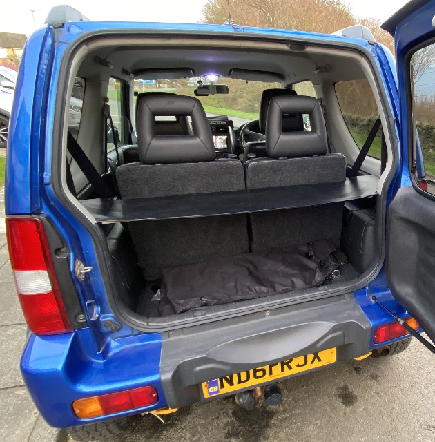

First a few parting photos of my Gen3, it was traded so the dealer wanted my to take it back to standard.
Robin
