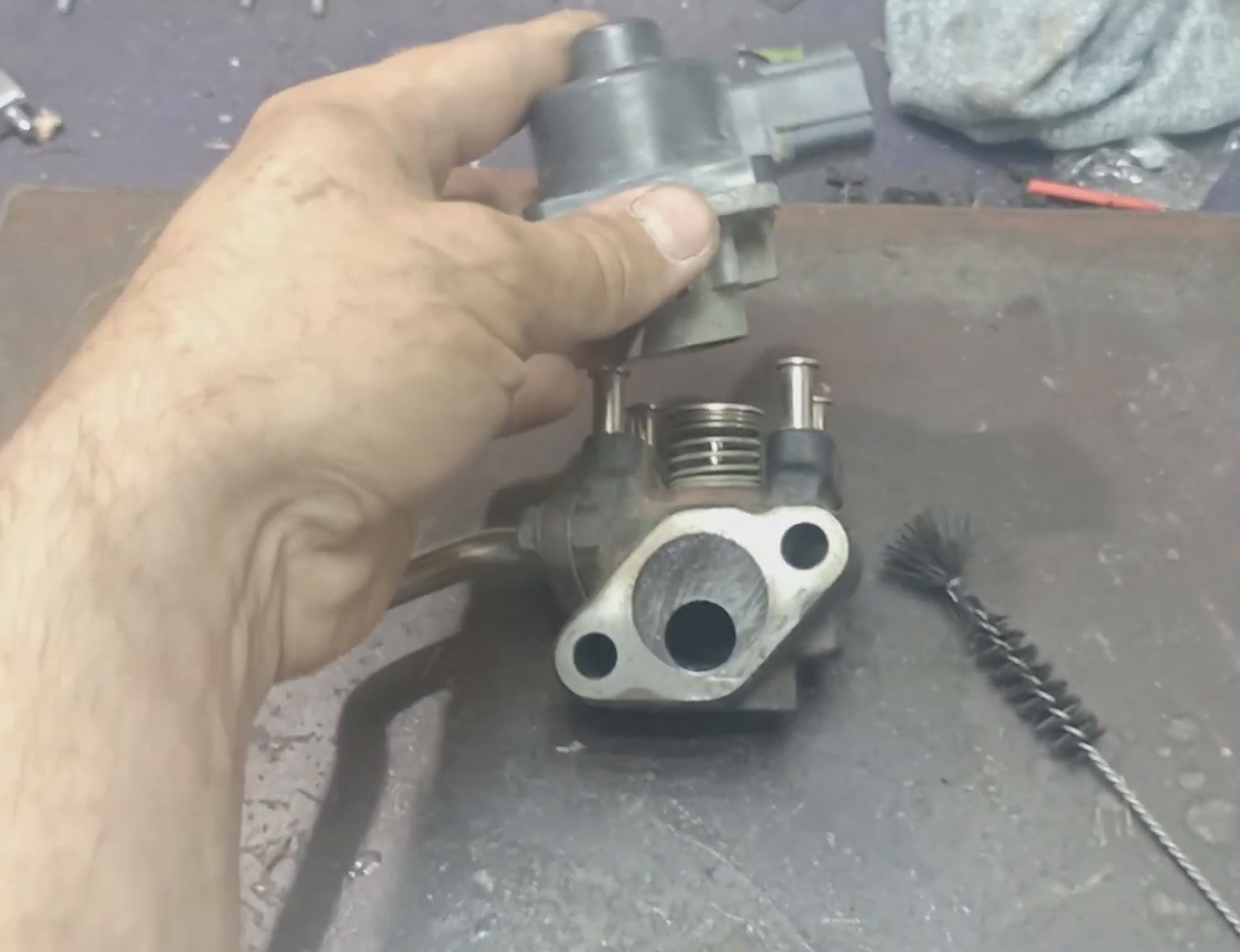

I’ve had my 2010 Jimny for 6 months and have hit my first problem.
Engine management light came on, code is PO403 EGR Circuit Malfunction.
Tried clearing it but it came back a short time later.
Everything points to an electrical problem, probably with the solenoid?
It seems like a right pain to change the entire EGR valve. Does anyone know if it’s possible to just change the solenoid section? It looks to be held in place by 4 screws and much easier to access.

Thanks for your reply.
The code suggests it’s an electrical fault rather than a flow issue.
The car only has 14k miles on it, so shouldn’t be too sooted up. It’s definitely not a bad idea to take it off and clean it at the same time but I have a feeling it’s the solenoid at fault.
I found a video on YouTube where the electrical section seems to have been removed separately, it would just be handy if I could swap it out instead of removing the whole valve.

I could be wrong, but I don't think that's a solenoid, it looks more like a stepper motor, how many electrical contacts are there in the connector? A stepper motor will typically have five or six.
A "circuit problem" is usually exactly that, a problem with wiring rather than a defective part, so before you go changing anything, at least 'ohm it out' to confirm it's defective - a six wire stepper motor is two sets of three wires, one of which is a center tap.
