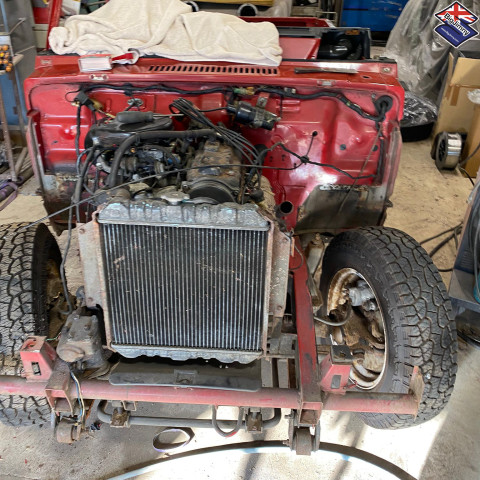

Up front, on the inner wing there is a "Fender protector" which is a piece of metal welded under the wing. These were inevitably completely rusted away, so there is a new set on its way.
Finally, here is the full hotrod/buggy look!
