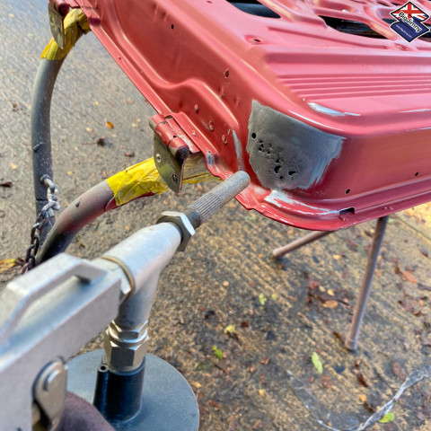

The process is the same on all the panels.
They are inspected for corrosion and any corrosion spots are sandblasted clean to remove all the rust.
Here, on the tail gate, you can see where the corrosion has been cleaned away from the mounting holes where a small amount of surface rust existed.
