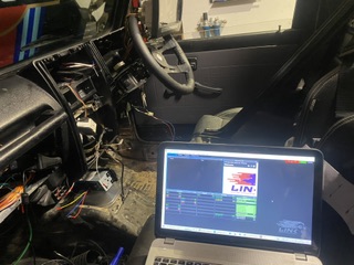

Things moved forward today… well sort of. 3 big things.
1: filled will oil and it stayed in
2: cranked it over and it spins smoothly
3: got the wiring part done and managed to connect the ECU to the laptop

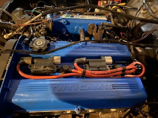

So things are slowly moving forward. Most of the engine wiring is done.
The injectors are now wired in sequence instead of all firing at once.
I’ve ground the reluctor wheel to a more normal shape.
The swift coils on plug are testing out.
A shot of ether up the intake and she stumbles… oil pressure light now works and switches off.
I’ve been setting up the ECU. Little vid attached hopefully. Maybe you can see a little something on the ignition on click. (It’s not running yet…)
