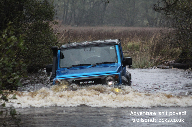

Good job I got the diff and transfer case breathers done....
Taken last Sunday on the Reeth to Ripon tour.
Robin
