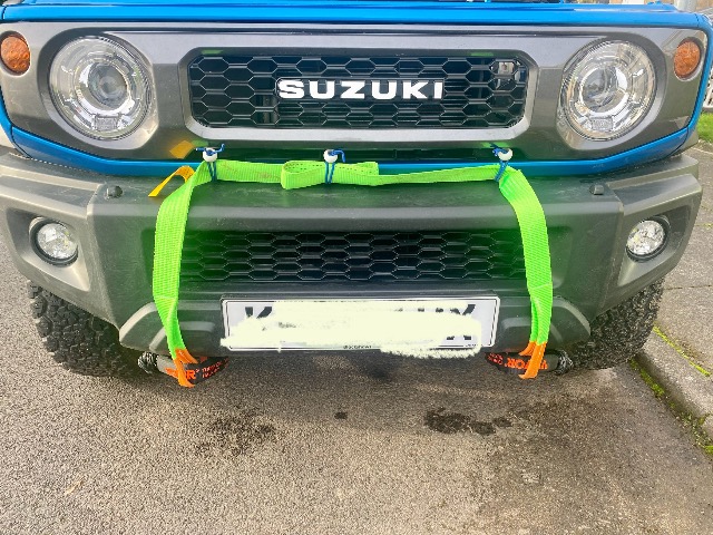

So I bought some shock cord loops and threaded them through the front grille support (it’s metal) and these hold the bridle in place.
The shock cord loops tuck in to the grille and won’t be noticed so I will leave them in place and just fit the bridle when required.
If the bridle catches on anything it will just pull out of the shock cord and won’t do any damage.
