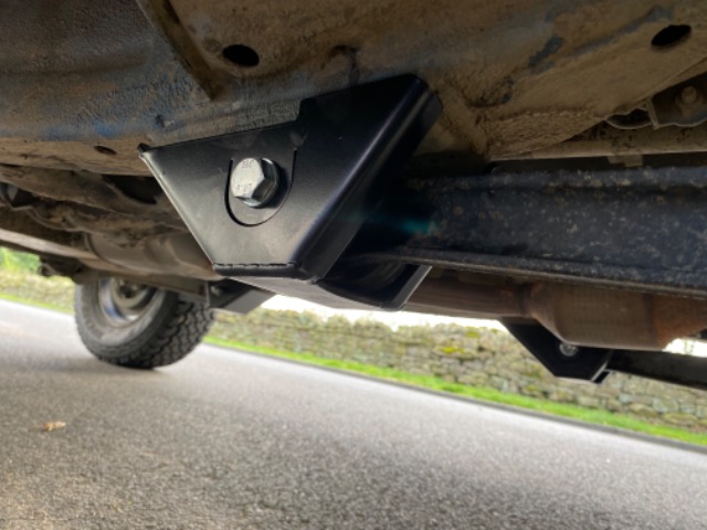

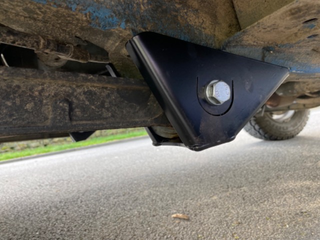

I fitted radius arm guards today, had them for about 3 weeks, but what with a holiday and the wet weather, this was the first chance.
I also have front and rear diff guards as well as a trasnfer case guard to fit, but they will have to wait unit I fit the Des Sol breather kit.

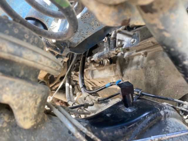

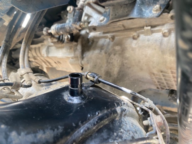

I fitted my Des Sol breather kit this morning. Although it went well I only got the front diff done, it took some time to route the breather pipe down the engine bay, the pipe kept twisting into the wrong place.
A tip, soak the pipe in hot water and hang with a weight, makes the pipe soft and easier to thread through.
The old valve removed, came off easy

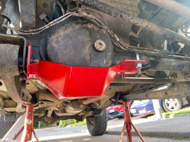

Whilst I had the front of the car jacked I fitted a front diff protector as I have a trial on Sunday and a trek the following weekend
I decided to spray it red so it will be easier to spot when I have scraped it and of course paint something red and it adds 50% to the strength.
The Des Sol breather adapter and pipe fitted
The breather box and filter

The bright red front diff protector is no long bright red, but at least it's done it's job and apart from a couple of new scrapes underneath nothing major was broken.
