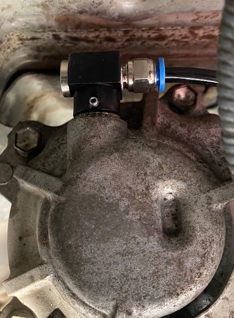

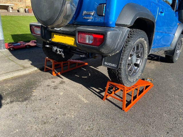

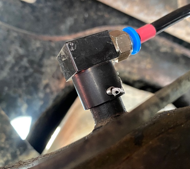

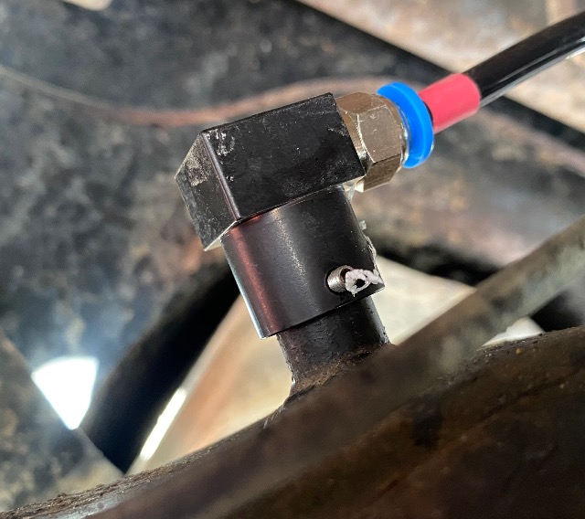

I finished off the Des Sol breather kit install today, fitting the rear diff breather and the transfer case breather, then running the lines forward to the filter box next to the battery.
The rear diff was the easiest to reach and was straight forward to do.
I wasn't looking forwards to doing the transfer case, but with the car up on ramps and a new purchase (crawler board) it was actually easier than expected.
Finally all of the hose was routed to the front along the brake pipes, tucked up high and tied with cable ties.
It's taken me two mornings and about 5 hours to do the whole job, but I didn't rush and I was impressed with the Des Sol kit, the breather mounting points are good and solid and well thought out.
