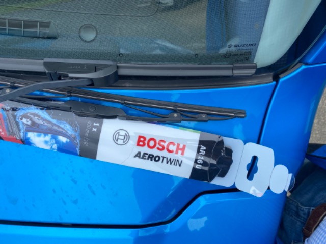

One of my front wiper blades split, so I took the opportunity to upgrade to Bosch Aero Twin
Good job I did, that very evening there was a massive thunderstorm and some torrential rain.

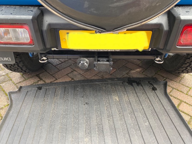

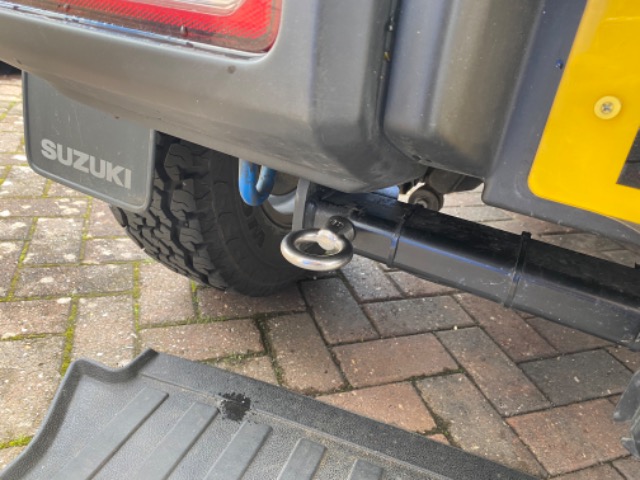

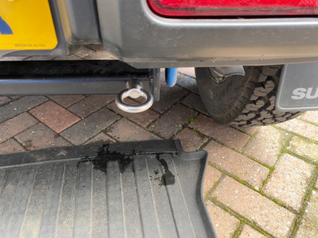

Fitted two towing eyes to the tow bar for light recovery as I have a couple of off road days coming up.
The factory tow bar was tough as old boots, it blunted my 16mm drill and I had to get another to finish the job. The eye bolts are 4t break strain, so about 750kg SWL, I will us a bridle and both eye bolts, that should easily be enough to pull me out unless I am stuck up to the axles.
