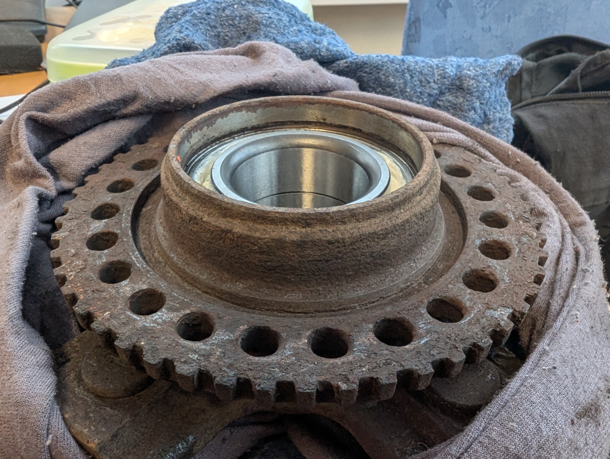

Got the gearbox in last night so went straight on with the hub. Got it out, and pressed out the worn bearing last night.
Put the new bearing in the freezer over night, and this morning I heated the hub to 200 degrees with a blow torch.
The new bearing just slid straight in and there was no need for a press.
A puddle of oil has formed under the hub during the time it sat in the garage.
So putting new seals in the hub and knuckle tonight and also changing the shaft seal.

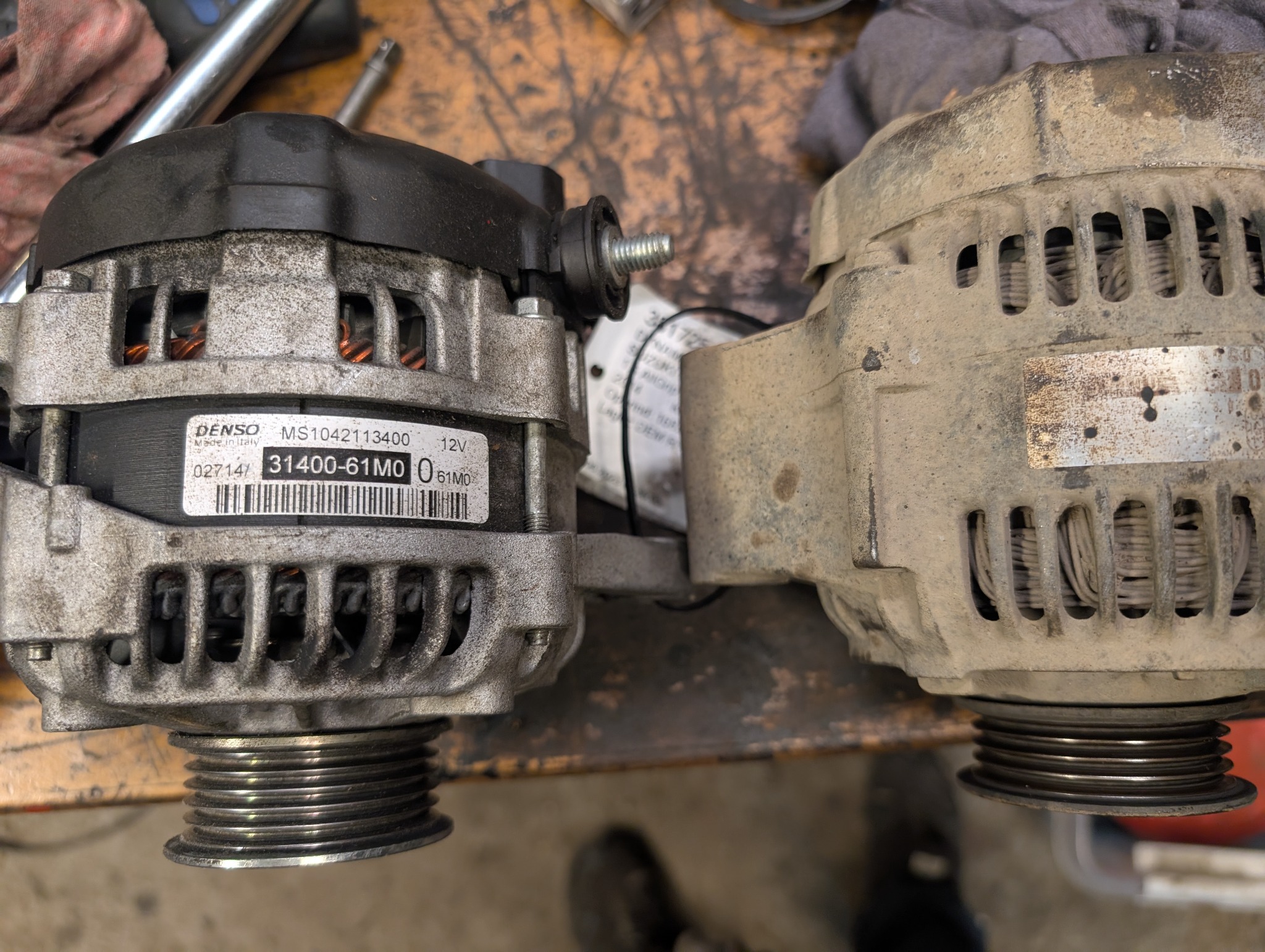

So the alternator from SX4 Scross is just the same build dimension and same diameter wheel as the original jimny alternator.All m13 and m16 are most likely all the same.
It fits just fine and except for the connectors it is all plug and play
With 100A it is not a too big upgrade, but if you would like a bigger or second battery, this will do in most cases.

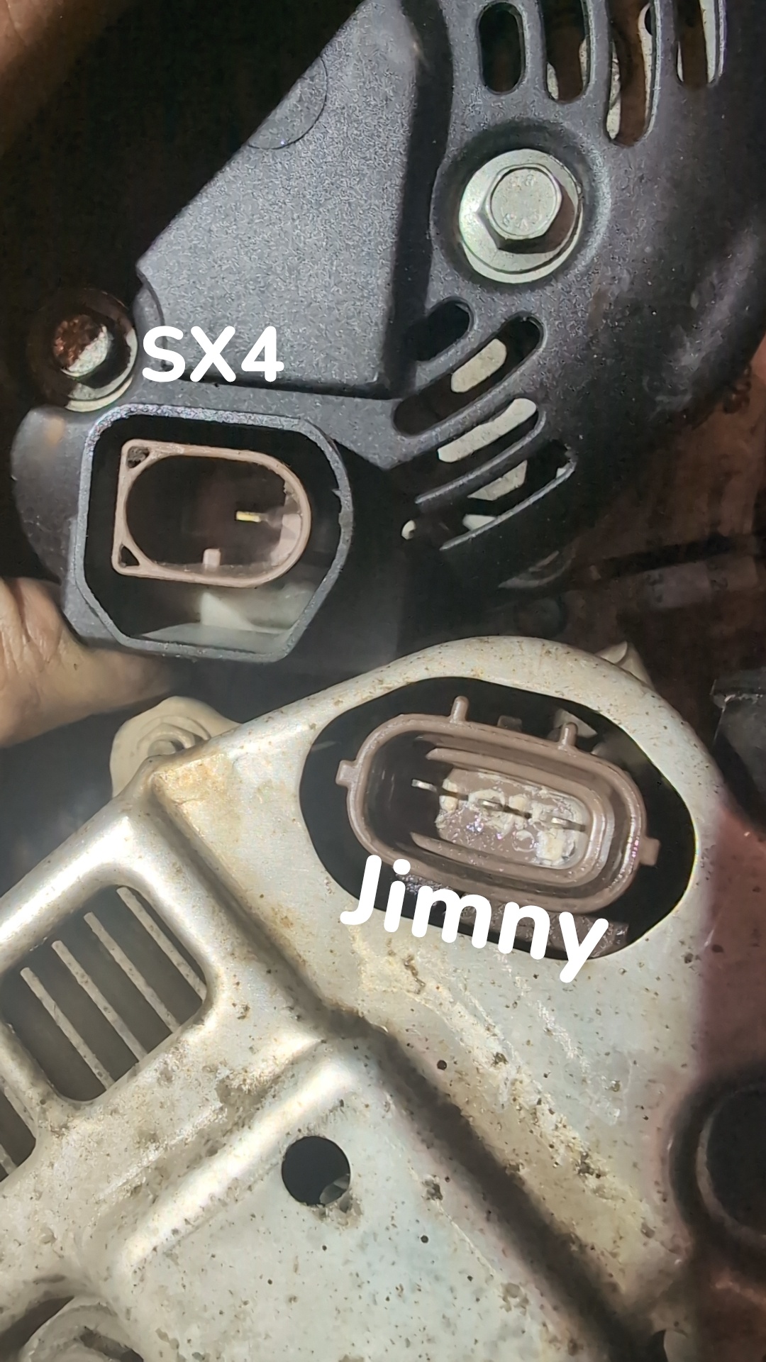

The jimny alt have three pins where only two is used. The one with White / red is for the charge lamp in the dash and all you need to hook up to the single pin on the 100A alt.
The plus connector is bigger on the SX4 but you should get an extra or New wire to the battery anyway.
Charging now is great even when my victron 30A lithium charger kick in.
EDIT: A few weeks after now I notice the belt squeek a bit from time to time. Tightened maybe a bit too much now but still holds.
The 100A alternator has a five row belt/pulley and the jimny is a four row. It might be asking too much to get 100A out of the four row belt.
I have adjusted the delay on the 30A Victron charger so it kicks in a few minutes later after start up. That helped a bit too.
