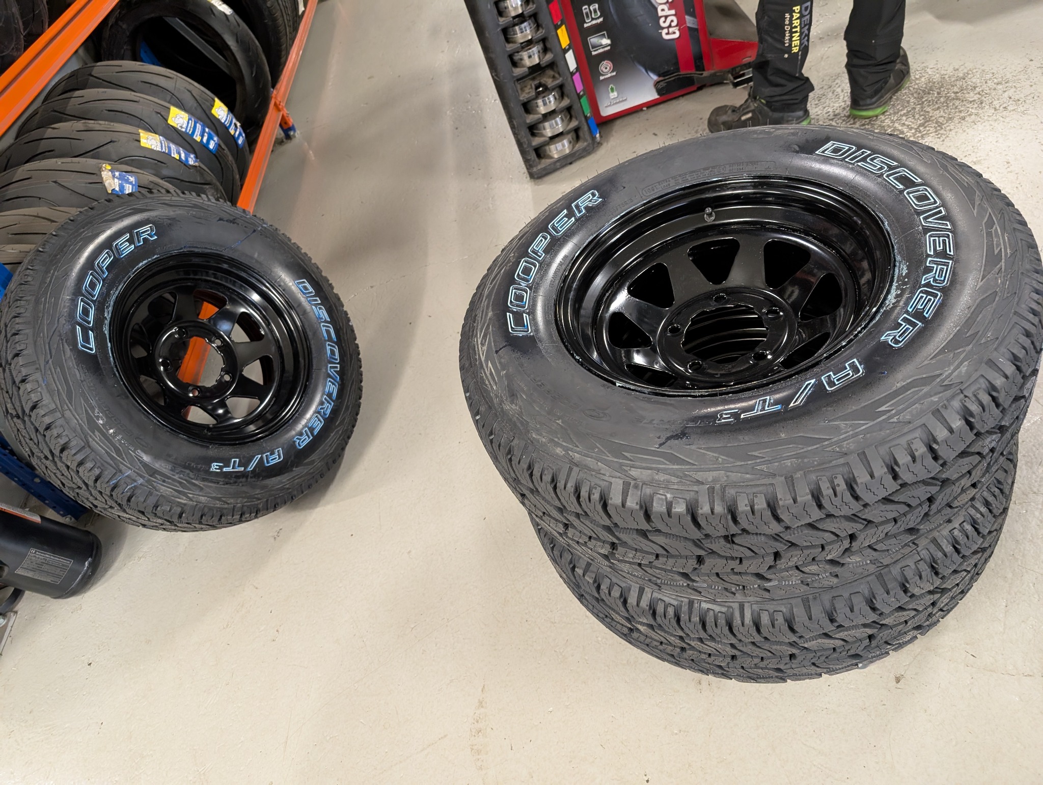

Got the wheels back from powder coating last night, so straight on to the tyre shop to get the rubber on them this morning.
Hoping to get them on the car during the weekend. Have to change a wheel bearing first.

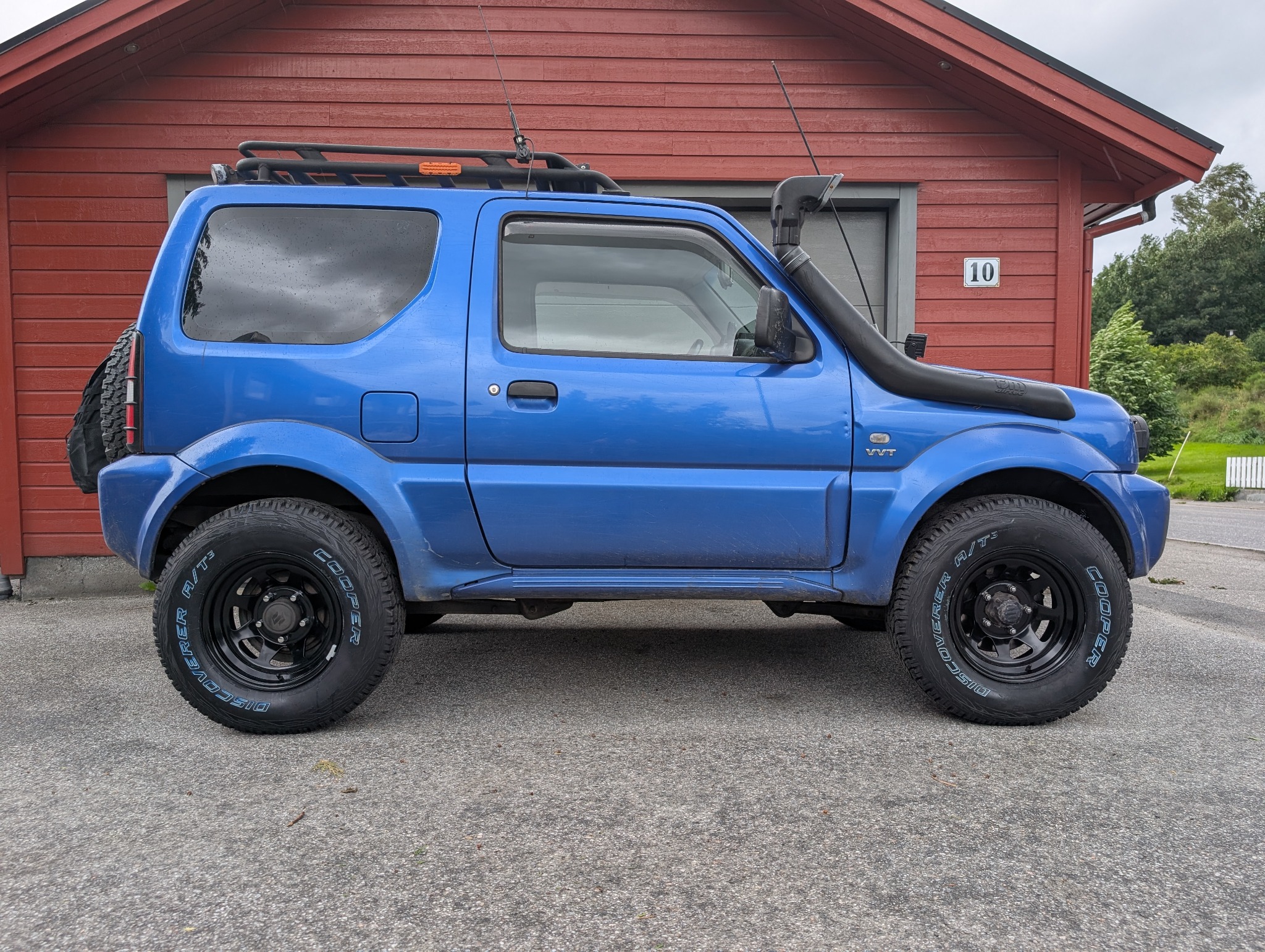

They look really good!
08 Aug 2025 15:40 #261543
Not much cutting needed. Look the part but stick out a tad bit much to slide thru the technical checkpoints I am afraid.

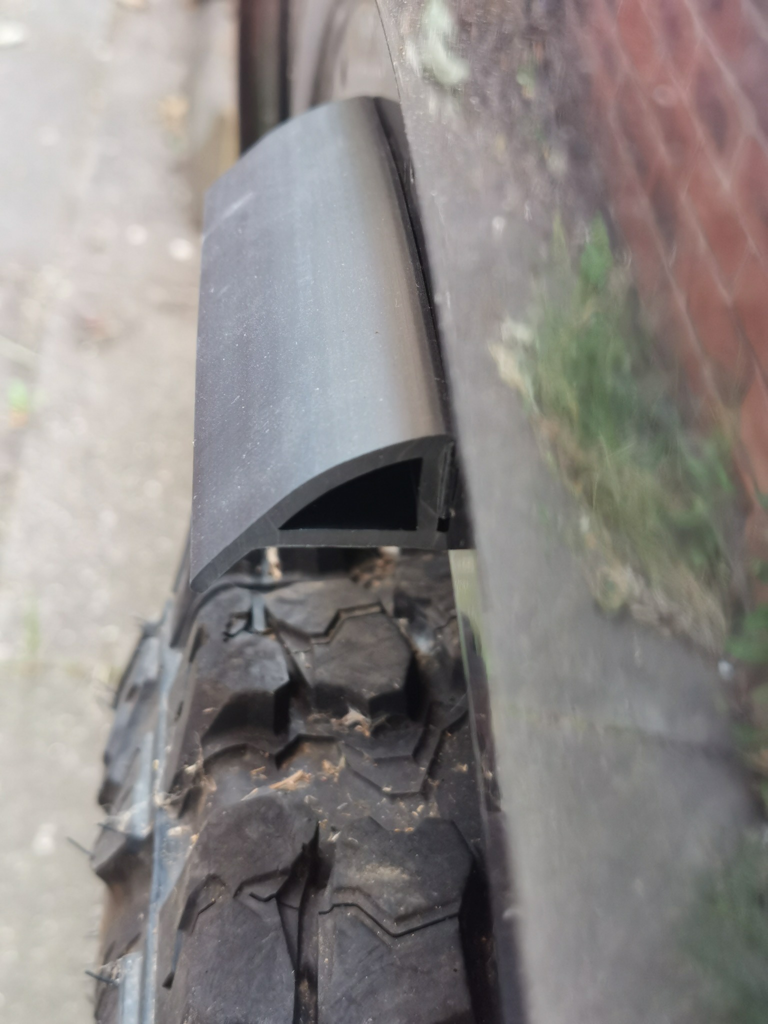

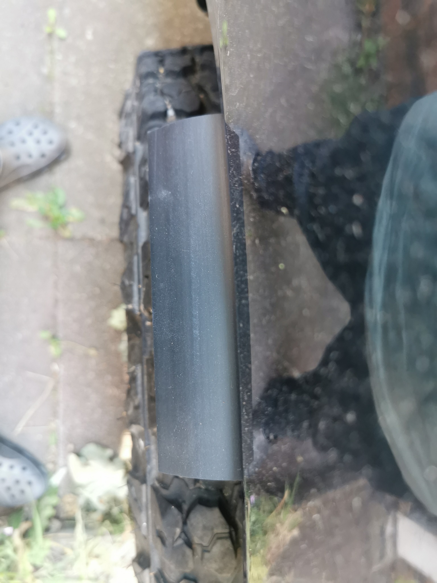

If you're on about protruding from the arches
I'm going to go with easywider.co.uk
They sent me this 35mm extension sample to try

just recieved some crap from ebay wich was said was rubber but was stiff plastic and impossible to get to follow the arch. I have opened a case so hoping to get a refund as they where not as wide either.
I'll check out your recommendation!
