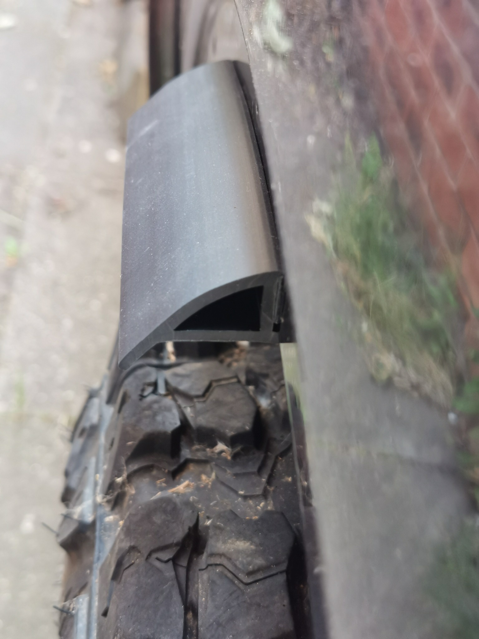

If you're on about protruding from the arches
I'm going to go with easywider.co.uk
They sent me this 35mm extension sample to try

just recieved some crap from ebay wich was said was rubber but was stiff plastic and impossible to get to follow the arch. I have opened a case so hoping to get a refund as they where not as wide either.
I'll check out your recommendation!
