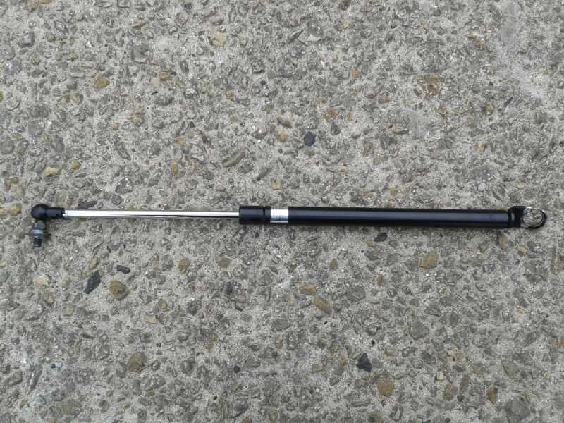

noticed my rear door strut was rather noisy and may have been the perpetrator of the clunking i'm suffering from, so asked a favor from Dan (Daniel30) and this was what he came up with
it sounded so much quieter than mine that I felt I must be onto something
here's mine

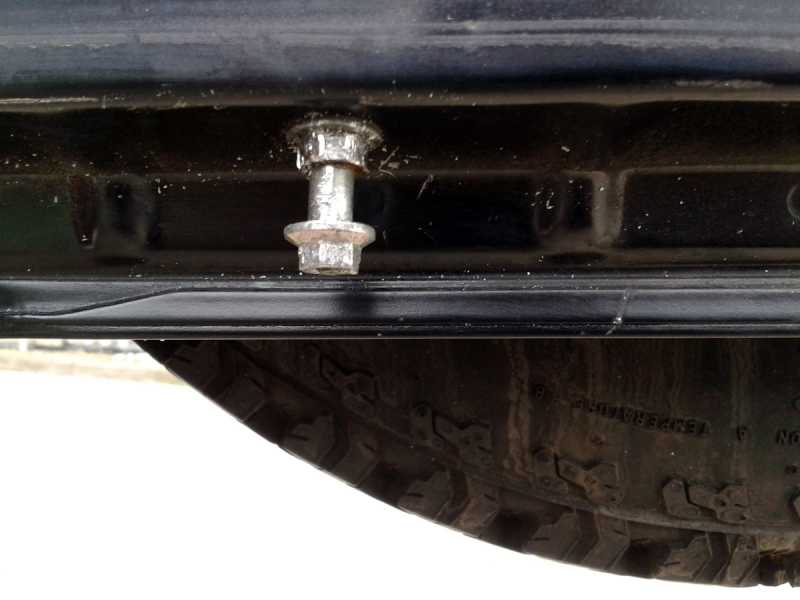

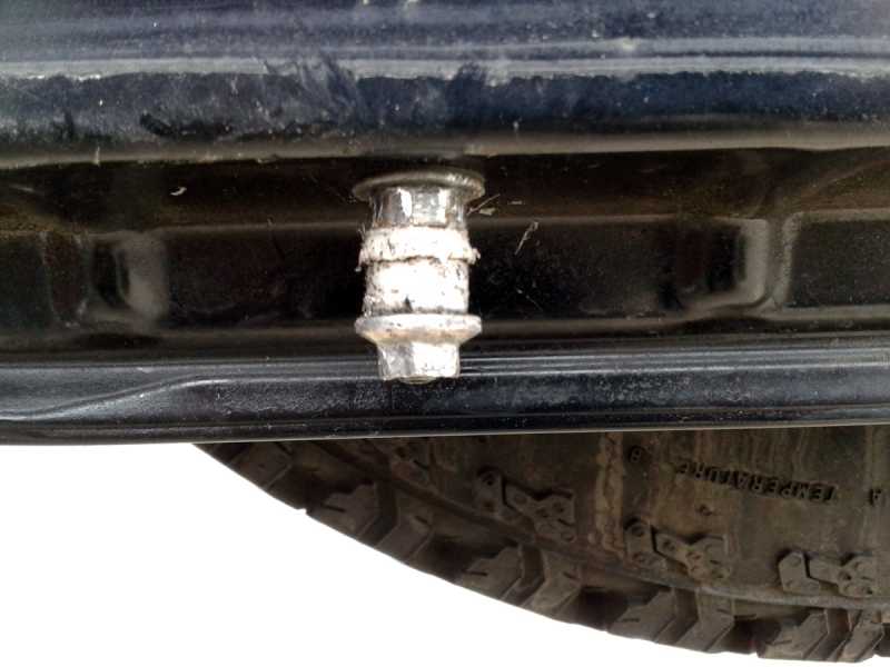

so it was off with the bumper and the wrecking commenced
removed at the bumper fixing,

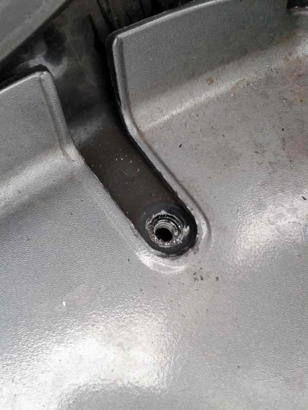

the door fixing was totally seized so destruction prevailed
I shall deal with this later

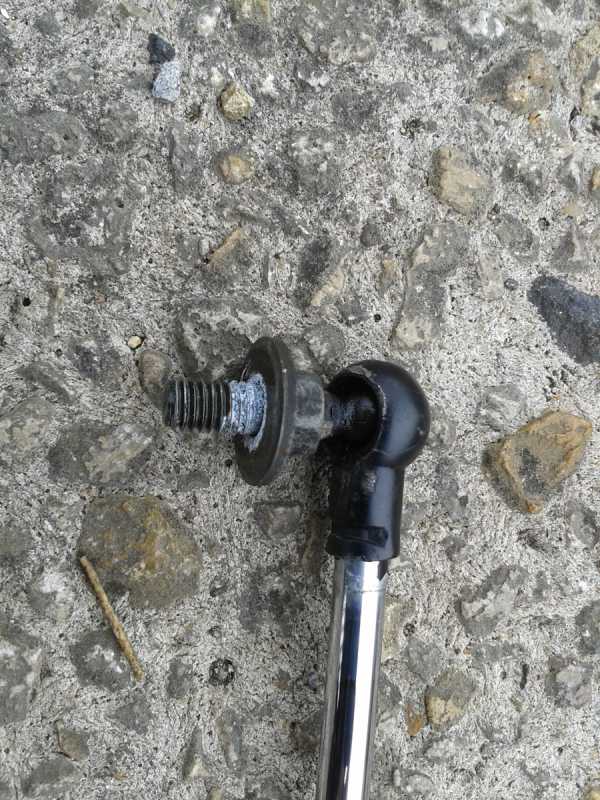

here's the strut,
the ball does not separate from the cup
first impressions indicate the clunking has gone, but shall test in morning without the beast jumping around in the boot.
