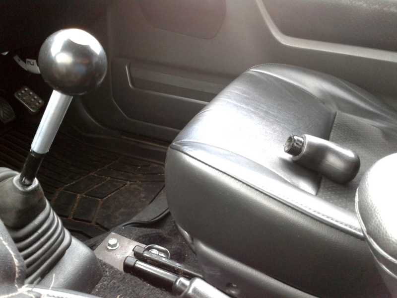

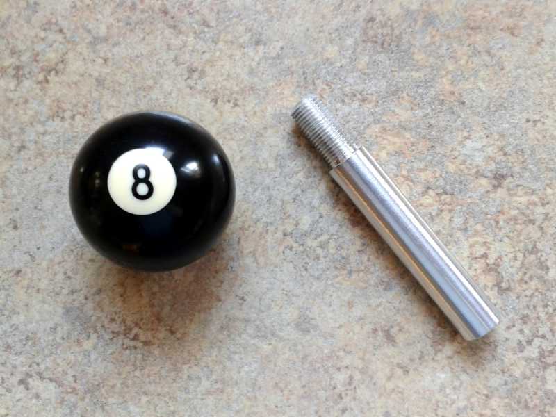

No eBay APP ID and/or Cert ID defined in Kunena configurationAfter the body lift the gear knob was 2 inches lower and a little awkward with the armrest down, so looked for a fix ....

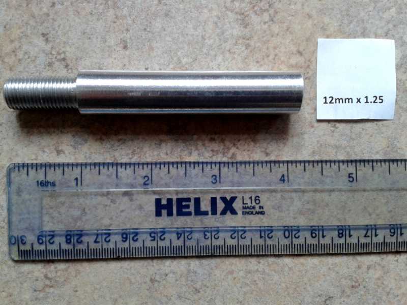

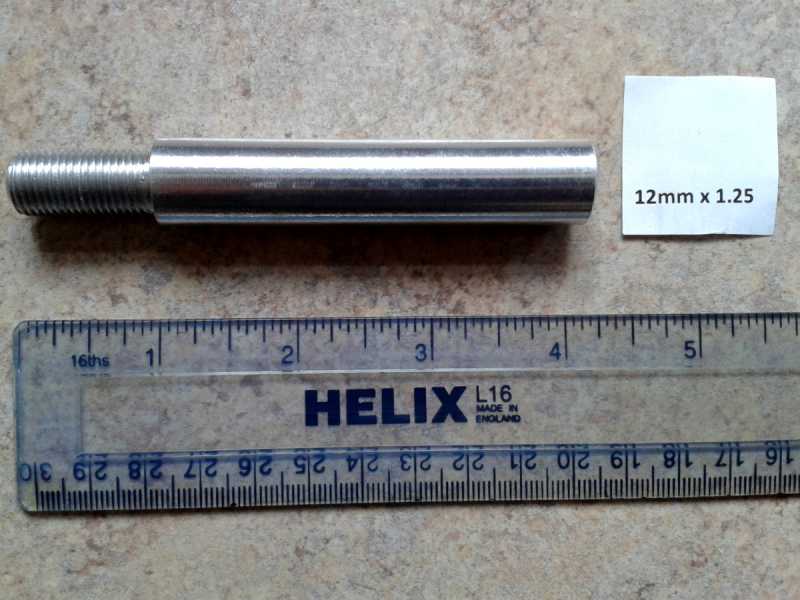

managed to crack the gear knob off (mole grips on shaft) wrench on gear knob - so ordered a gear stick extension from Utah (USA) for £11.82 delivered
M12 x 1.25mm fine thread x 3 inch (75mm)
ordered 02/07 - arrived 9/07 - pretty good

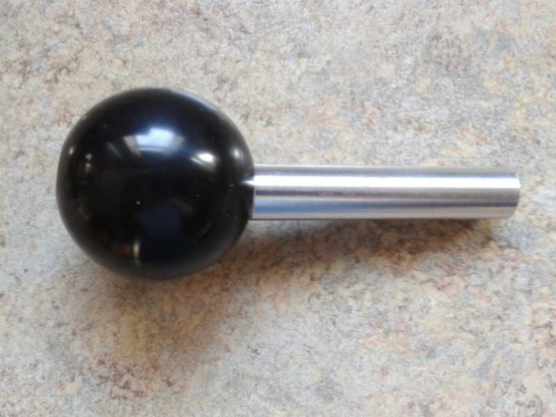

tried the original gear knob on .... wouldn't fit as the non-threaded portion was to wide to allow entry to reach the internal thread of the knob .... could have drilled it out ...but fancied a change so contacted Rob (Kirkynut) as recalled he had fitted a 5 ball and he driected me to retrogearknob.com
for £7.89 delivered (thanks Mate)
loving it
