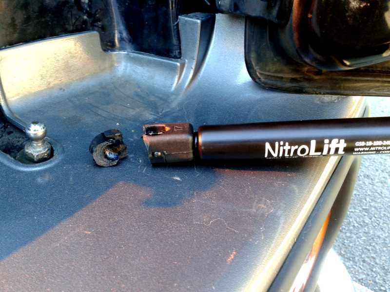

SGS strut update .... not happy, IMO these are not fit for purpose
unlike the OEM struts which have metal sockets to fit the bumper "screw in ball", these replacement parts are only made of plastic - which combined with the fact that the strut is more powerful than the OEM one, flings the door open with considerable force, but it cannot take the strain.
currently talking to th supplier will advise when resolved.

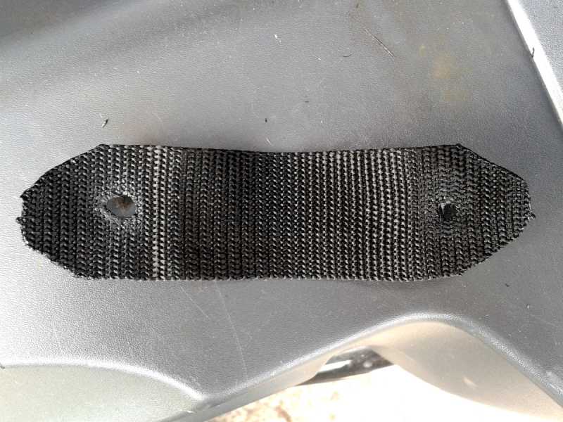

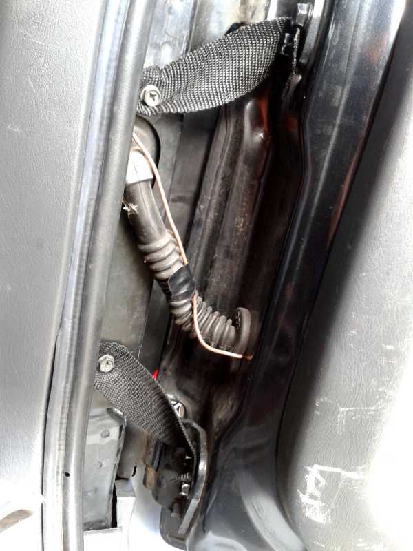

made some temp hinge straps to stop the door opening too far and damaging the hinges/door skin/bumper
using a shoulder strap form an old bag :lol:
