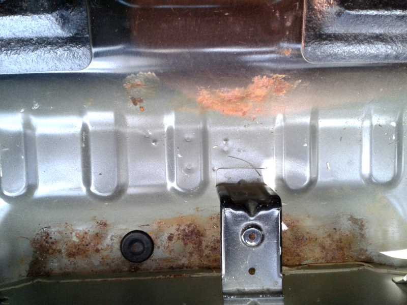

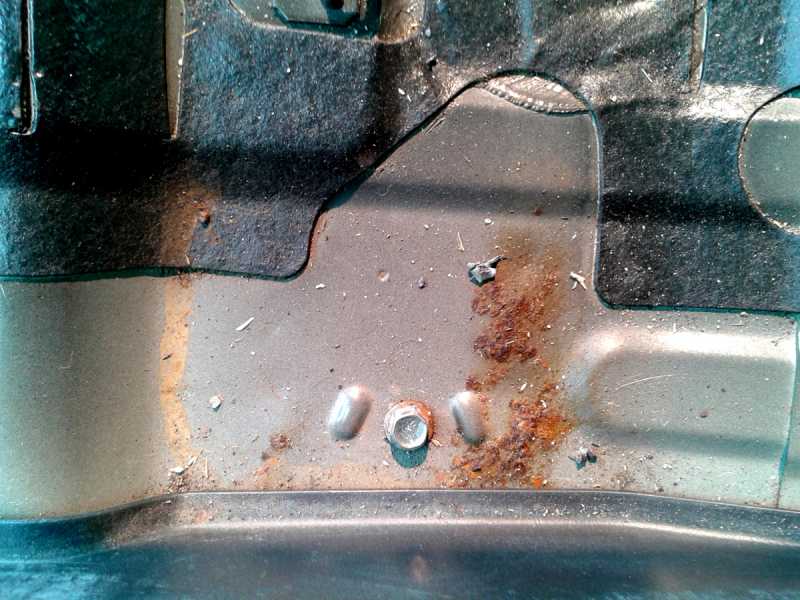

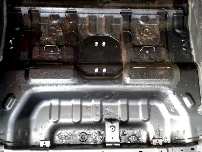

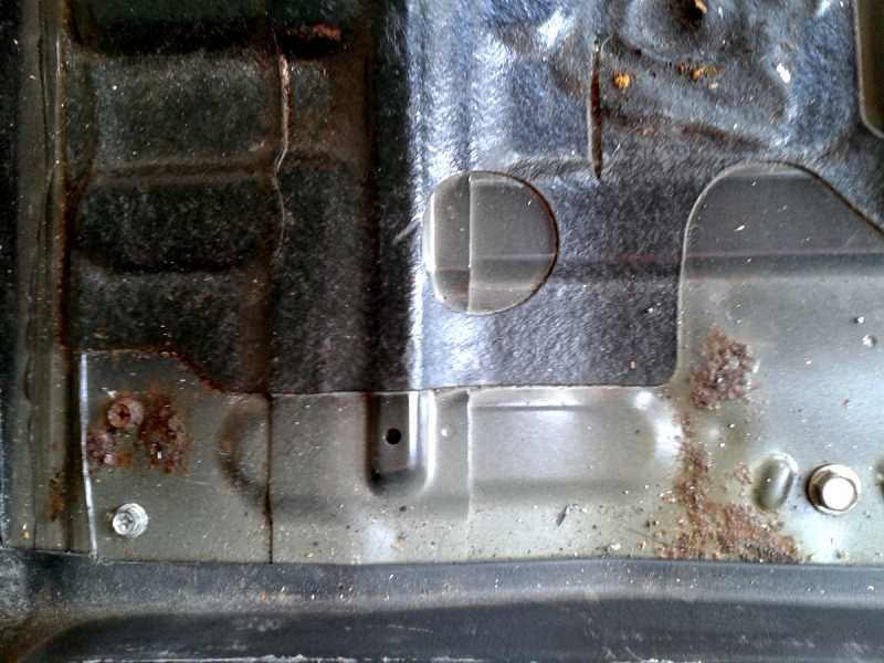

01 Sep 2015 14:40 #151113 by Halford
spotted some rust through the tiny gap to the jack space under my flooring so thought it time to peak,
WTF ..... 2007 jimny, well OK that's 8 year old now - but confused as rust hasn't come through from underneath, it's actually top down rust, has the GWP been that scared by my driving that she's wet herself :ohmy:
immediate action - unleashed the rust convertor - this ones the Flagg Rust convertor from toolstation
next step will be to take the side panels out again, check for any more, then smooth hammerite the lot ;)
so much happening at the lotty at the moment that may run out of decent weather to get the underside done :(

Sorry to see you have rust, but... my car is exactly year and has the same rot in the same places :(
I don't feel so bad now I see same aged car with the same amount of moth :)

Take that you nasty rust bug ..... :angry:
