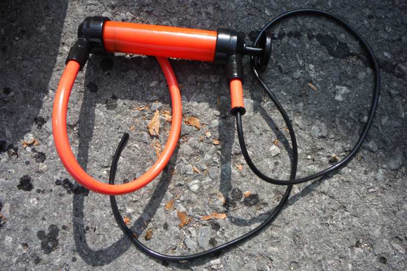

Ok so its was time to replace the gearbox oil with castrol ep80-90 gl-4,as with alot of jimny the bottom gearbox plug was locked tight :sick: , but the top one was ok
,so it was down to pumping it out with my £9.99 syphon pump of ebay then fill it back up with the oil suction pump from screwfix.
