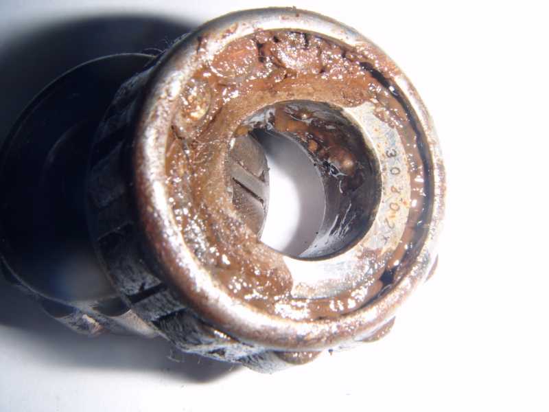

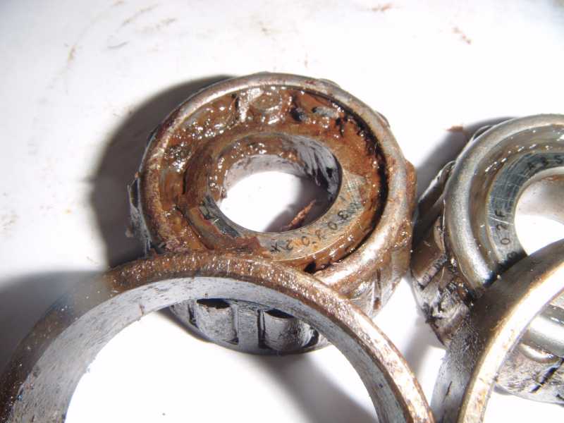

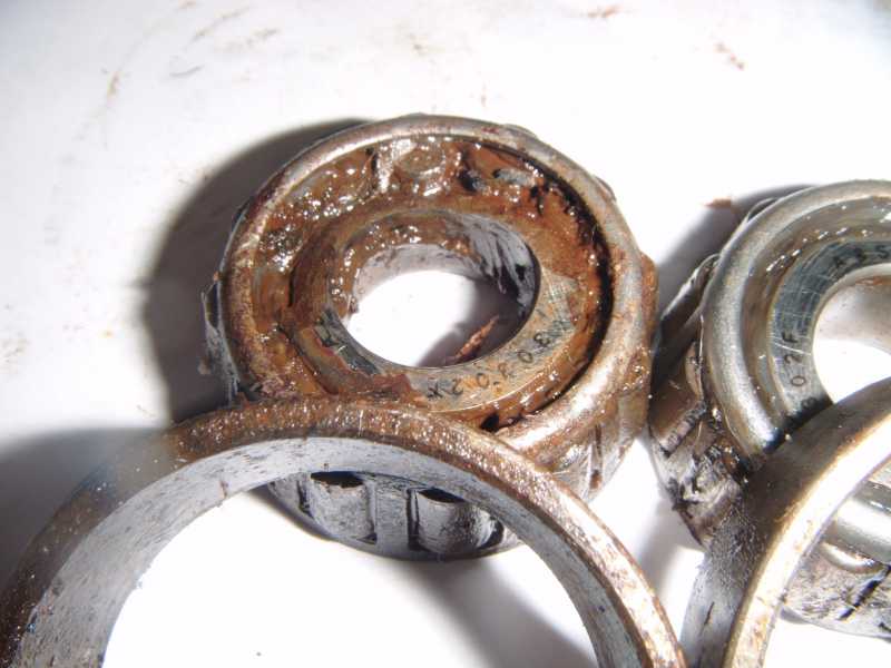

Ok it was time to change the kingpins so it was off down to Martins (BIG JIMNY SHOP) to pick up two new sets of king pins bearings+oil seals + waterproof grease + copper silicone sealant.
This was my first time at replacing the king pins, so I down loaded the (how to? guide) from this forum and printed it off, then I just got on with doing the job.
I even removed the bolts on the backing plate, so I could copper grease the bolts as you need to remove them if your are replace the wheel bearings at a later date (you can do the job with out removing the bolts and leave the back plate in place .)
I've only replaced the driver's side at the moment as that side was leaking oil and the weather was so bad, rain and snow.
The top bearing was OK but the lower one was a right mess some of the top of the bearing was missing so the bearing started to disintegrate, here are some photos to look at,so if yours are leaking oil this is the time to replace them.
The job takes about 2 hour and that was my first go at doing the kingpins, so if you have a go just take your time.

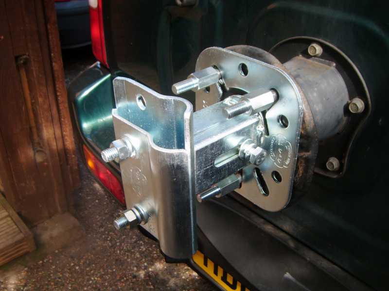

dirtydogz wrote: Decided to get a jack bracket from Russ at Jimnybits to fit my micro shovel on the back spare wheel bracket ready for the winter, so I don't have to have a wet carpet like the last two years. :sick:
Bracket cost £35.99 inc vat and pp. www.jimnybits.co.uk/shop/recovery/farm-j...racket/prod_572.html
Just some photos of it fitted.
Decided not to use the wheel spacer studs to fix the bracket, I just drilled two 6mm holes and bolted it to the spare wheel bracket,
www.screwfix.com/p/roughneck-micro-shaft...d-point-shovel/53829
That is so awesome!
Looking great DirtyDogz!
