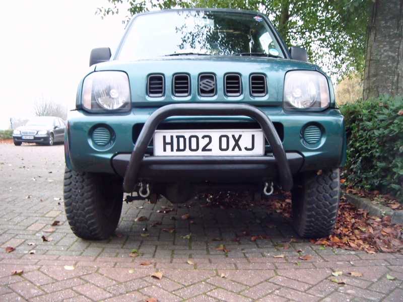

Replied by dirtydogz on topic Re: DIRTYDOGZ JIMNY A BAR
Fitted my new A BAR today got it off Ebay for £129+£20pp,
Its made for a 2005 JIMNY so i had to get some new brackets to fit it on.
2002 JLX Soft Top B)
Jimnybits 2" lift +Pro Comp ES1000 shocks.:) Big Jimny rear shock mounts. Big Jimny adjustable panhard rods.

  • biggaz
19 Mar 2011 14:38 #13613 by biggaz
Replied by biggaz on topic Re: DIRTYDOGZ JIMNY
that bar look really good, not too big or small... JUST right!

  • bertbuckie
19 Mar 2011 21:07 #13640 by bertbuckie
Replied by bertbuckie on topic Re: DIRTYDOGZ JIMNY
looking good :)
did you spray the Suzuki badge black ?
19 Mar 2011 21:19 - 08 Apr 2012 13:25 #13647 by dirtydogz
No just removed the Suzuki silver S .
