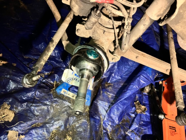

Thanks Robin.
this was the end of play yesterday, one side done and this side nearly finished.
my local mechanic blobbed a bit of weld on the bolt and mole gripped it off. Just waiting for new ones to come today. Stainless. Bit concerned about the state of the rubber bushes in both front caliper sliders but think I’ll get the garage to sort that.

Question.
Both videos I’ve watched (on wiki and another on YouTube) pop the kingpins in, hub back over and swivel seal on.
The wiki wording says fill knuckle with 100m of grease.
I have not done this, as it wasn’t shown in either video and I must have missed it.
So before I slide the hub over and back on, is that grease around the CV in the joint itself?
Or is this not needed as I have grease on the kingpins, in the bearings and within the cv itself?
Bit confused as not in the video and is on the wording. If it needs it I’ll have to take the other side apart again…..

Replied by Lambert on topic Caliper stuck
It's in the CV joint itself. The hub and chalice are ostensibly dry with the obvious exception of any cast off. Some people argue that the entire thing is packed with grease to keep the water out but this is entirely unnecessary if the outer hub seal and it's mating face are in good condition. If they are not then the over packed grease will escape anyway and so it serves no purpose. Just grease the kingpin bearings and the CV itself and you are good to go.
