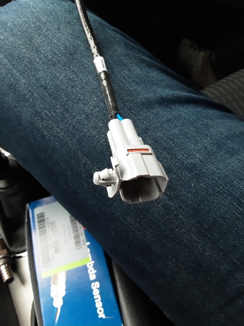

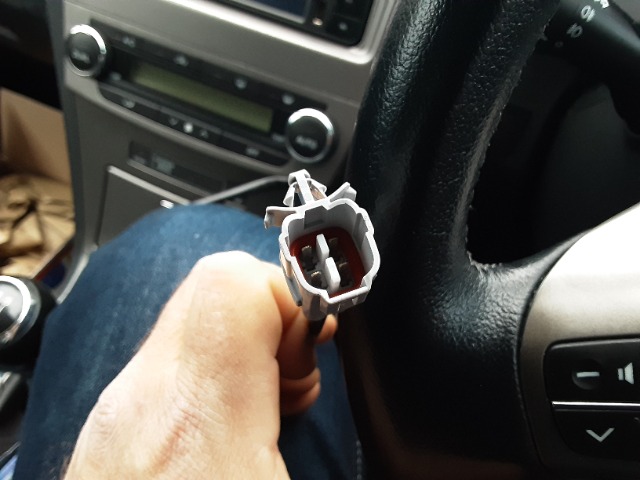

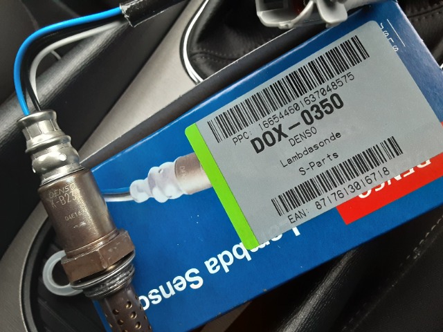

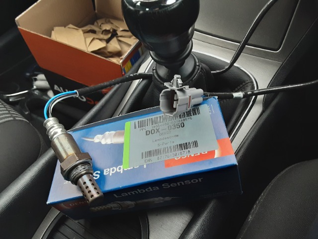

Just thought I would share a few photos of the correct POST-CAT Lamda Sensor for my 2005 VVT M13A Jimny.
I say correct, because this very same model which was fitted into my old rusty exhaust pipe where from I could not remove the old sensor.
I had replaced the rusty Catalysator section with a brand new one which was supplied with a 'compatible' O2 sensor (bundle on e-bay...) Unfortunately it did no good because the connector was different/incompatible and once I managed to fit and the engine got a bit warm the sensor pushed the revs into 1500 RPM range instead of the normal 750 RPM. I hope this will sort out my issue. If not then the my investigation will continue.
So the new correct sensor is this (this is not the one from ebay):

I don't know what would be the original/factory O2 sensor then.
This Denso DOX-0350 model had come already fitted with the vehicle back in 2015 when I bought the car. Never had any issues with it, all emission values were well below the limit of MOT tests in the last 5 years. Hence I thought this is the correct one. Now you made me nervous as it cost me 78.41 GBP delivered. So which one is the original if not this?
