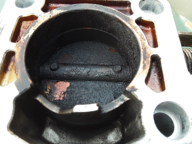

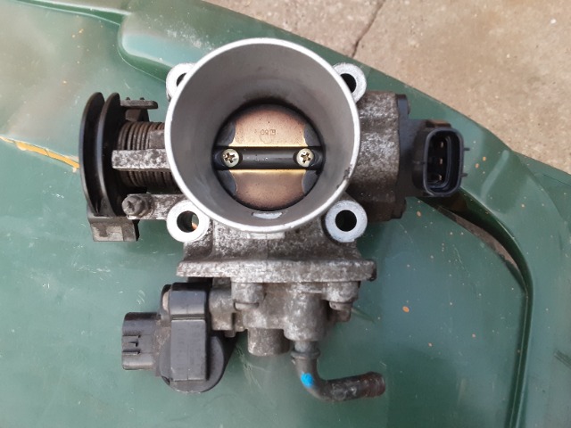

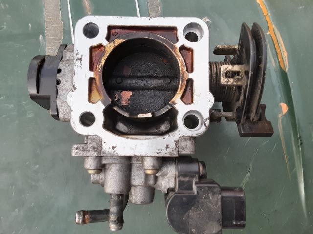

Well, it's been 7 months since I was here. During these month I was not able to investigate the cause of idling problems of my M13A engine. All I could do recently is removing and cleaning the throttle body and the IAC valve as suggested.
Despite of a thorough clean there is no improvement. I run out of ideas. Looks like it's not going to be running for the rest of the year. Photos before cleaning.

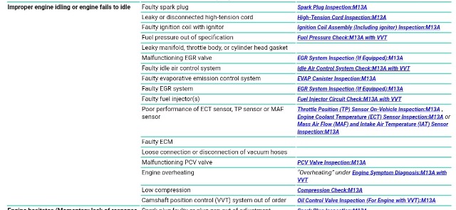

Replied by HUN on topic Correct Lamda Sensor for a 2005 VVT M13A Jimny
Thanks again DrRobin for sending that link in November last year. It will be my guide.
suzukijimny.automotive-manuals.com/S8R70A1124010.html
Here is the list of things I need to check:
Seems endless, but I'm not in a rush.

The inlet side of the throttle body look reasonably clean, but the engine side has a lot of deposits on it, unless this is the before picture?
You might find these deposits are causing the butterfly valve to stick. That would explain the uneven idle but not the fault codes.
Robin
Robin
