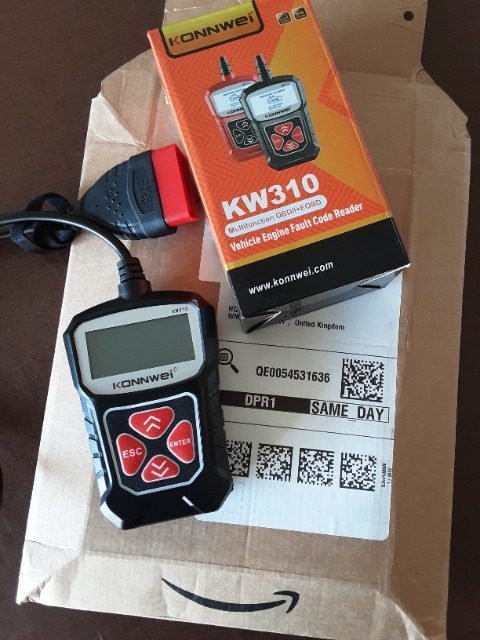

Well, thanks to Amazon rush delivery the OBD2 reader I ordered last night has arrived 8am this morning!
It's been plugged in but sadly it could not find any pending/stored DTC. No MIL light on dashboard, no error codes stored, just high RPM...it seems the high RPM is temperature related so I need to figure out which sensor is doing that.
This is exactly what I most wanted to avoid...I just call it guess work!
